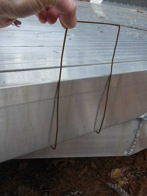

This trailer only has 4 anchor points, one at each corner. I like the side wheel net/losso but I have nothing to attach to.
Does anyone know if someone makes a hook that can catch the trailer frame? Here is a mock-up with a coat hanger. It would be great to have something like this in 1/2" alloy steel. I can make something, but if anyone has seen anything like this please let me know, thanks!

I would put bolt-on D-rings on the frame rail instead, with a decent size backing plate.
Ideally close to a crossmember.

That is my fall back option.
