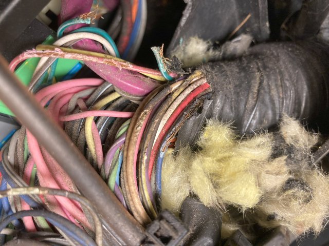

Last week, the Jeep TJ 3rd brake light failed, a mouse or chipmunk got behind the plastic fender liner and vapor canister, then gnawed through the wire. Took about 3 hours to disassemble, find, repair and reassemble. I’m old, I don’t need this aggravation! AND, it has ALWAYS been garaged!!!
Speedo and odo in the Silverado stopped working last winter. Not servos, not speed sensor, either the PCU or bad wire. Ordered another PCU, made arrangements with a shop to do crank re-learn, then found this under the fuse box (green wire w/white stripe at top of pic) :
Looks like they thought the space under the fuse box was a good place to live, and the wires were good eatin’!
If I went to a dealer, they would have replaced the PCU, charged maybe $1200, then told me it is something else! (Another reason I do all the maintenance I can!)

The TJ wiring was apparently gnawed years ago, the break in the insulation allowed the wires to corrode then break. When I did the repair and stripped the insulation the copper strands were black.
I patched a small hole near the overhead door maybe 8 years ago, that might have been when they did it. There were acorn shells near the evap, I suspect chipmunks. Do mice eat and carry acorns?
