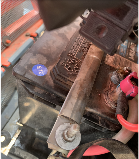

Damn batteries don’t last nowadays!
Did I say haven't replaced a battery since I started using float chargers?
Maybe it is as you are saying, the old ones are better? Could be...
