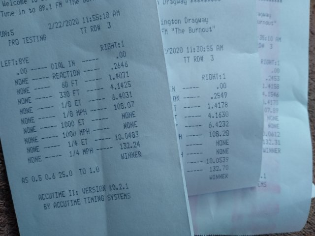

I'm at Darlington Dragway running my RE now. This place is FAST!
DA hovering at -1400, track on kill.
I've made 7 runs in the last hour. Some great, some less than great. All but one better than my previous best.
I changed from 315/50 to 305/45 MT's and switched from MT front-runners to Hoosiers. All other details are the same as Houston. Fuel is still 93 octane Shell.

Congrats , Nice passes , your 60' is killer !
Why did you go back to 305's ?

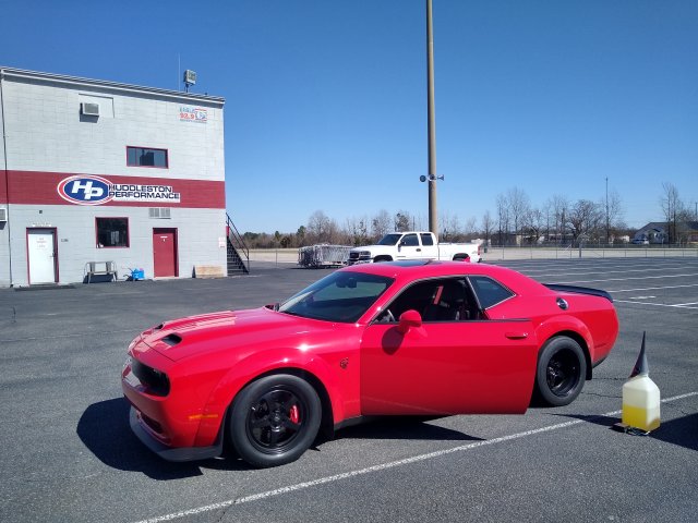

I went to HRP last night & had a PB of 9.83 @ 140.52 , 1.44 60'

If I had to guess, it’s because if you can hook on the 305 it’ll go faster than the 315. So if the track will take it, run the smallest, highest pressure tire that you can.

Good job Mean Cat! Houston is a great track.
Max, my car is stock w the "easy" 150 lbs removed. It has DR's and skinnies. No tune, pump gas, etc...
Jack, you are correct. The 28" 305 gives about 5% more gear. At Houston l was topping 5th gear at the finish line. Here in Darlington I'm going into 6th around 150 ft before the line. I'm 100% sure they'll be harder to hook on a bad track. But they sure work well for hero runs. Lol
Fwiw - I had to come here for business reasons and decided since the air was going to be good I'd put the little tires on and see if the RE would leave on them. It did. :)

I was assuming that , but I really like the 315's with the 2.85 & 309 set up , they pretty much hook all the time until the track gets real bad.

That's another reason I like the 315's , with the 305's I was shifting into 6th b4 the end of the 1/4 , 315's will hold 5th all the way through the 1/4.
I remove the front pass. seat , everything else is in the car , 1/2 tank of gas.

My guess is you lost 25-30 lbs with the change from MT front-runners to Hoosiers

Thanks guys. It was a fun outing. I doubt it'll go much quicker in it's stock form.. and I don't see myself changing shocks, springs, exhaust, etc.. I'd like to know why my mph is so low compared to most others. We keep making jokes that if I can get it to mph it'll really run good then. lol
Marine121 - I doubt I'll be back any time soon. I live in midTN and it's about 9 hrs to Darlington. I had other reasons to be there this time and knew the track would be great and there was a good chance of the DA being exceptional so I brought the RE along. It's a great place w great ownership and staff. I wish they were closer to me. :)
vortecd - you are correct. I did some digging and found there is a 14 lb difference between the two per tire. So, the car lost 28lbs from the tire change.

So close to a 9 sec pass! Nice slip! Mind me asking what rear tire pressure was and what RPM you launched at?

Thank you Max. First pass it went .05. That of course had us all thinking there was surely a way to find a 9. After 8 passes it was obvious it wasn't going to happen, at least not w 230 lb me in the seat. lol
Tire pressure was one of the few things we played with. I ran it from 17 up to 25 psi. The lower pressures resulted in slippage at the hit. The higher pressures actually left the line but it would slip on the 1-2 shift.
In the end 19-20 psi netted the best runs.
As for launch I've tried lots of different RPM's. Some just don't work well AT ALL for my car. Dead idle results in what feels like a lag and produces some sucky et's. Just off idle(12-1300) acts a good bit better but doesn't et very well.
From there the higher the better to a point. I've found that 1900rpm is the sweet spot for my car. It'll go as high as 2100 w out pushing but I can't stage it that high, when I let up on the brake to bump in it moves way too much. I can't race it like that so I don't often even try it like that. I did try it once at Darlington, it didn't pick up any et.
I hadn't planned on any more road trips(to good tracks that have great DA) but my best slip has so many 'almosts' on it that I may make a change or two and head out one more time. It's a shame TN is so far from sea level. lol

Great thanks! I ran my best 60ft 1.47 at 18psi and around 1800rpm launch. I noticed the same as you, after about 1900 the car wants to push itself too much and it's harder to control it. Last race (last year, lol), I was practicing bumping in and trying to get the hang of it. Had I more time I wanted to try putting the tire pressure up a bit to around 20psi or so. This is all assuming great prep. Crappy prep and I gotta lower my rpms as low as 1200 or so and keep my tires around 18psi.
