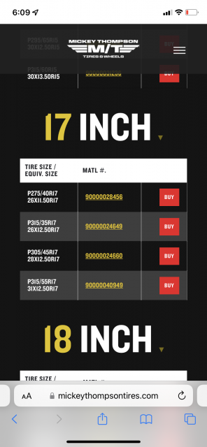

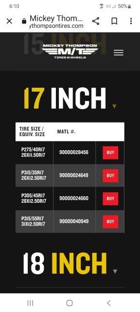

If I remember there's a 50 and 35 series in the 315. The 50 is quite a bit taller than what I have now and the 35 is shorter than the 45 - 305 - 18" on it now.

55s.. Super tall.

The 55s are huge baloneys and the 35s are really short.
we are not talking 55s 315/50s

The 35s are over 3" shorter than what I have now. That adds a bunch of gear which I'm not sure that it needs.
