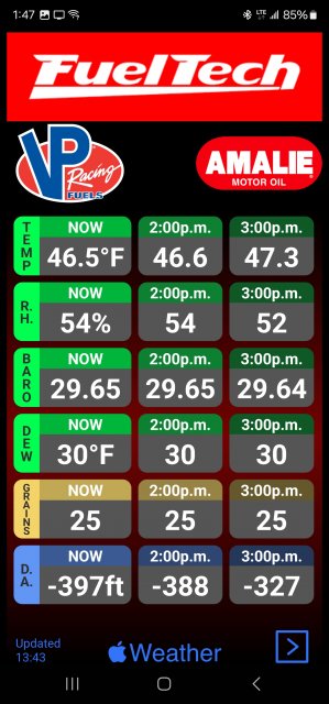

I'm impressed considering the track conditions and the weather. Baro is low and the DA is negative 397 or so.

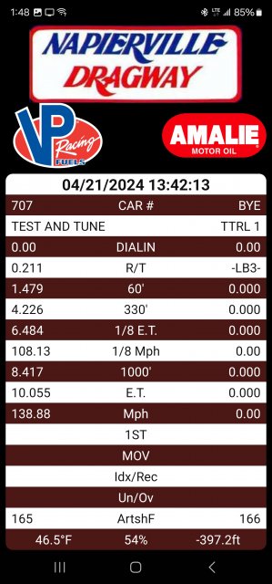

So I drop the pressures in the rear to 19.5 and leave at 1600-1700 rpm or so. Which is what I do when traction is an issue. The board shows 1.47 60' then 6.48 in the 1/8. Hmm this is going to be a decent pass as my other 1/8 times were 6.5x-6.6x.
I get back and check the app.

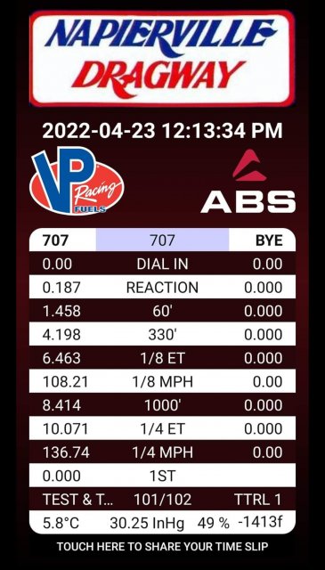

10.055@138.88. Holy c--p a new pb and the previous best of 10.064 was in neg 1200to negative 1300 da with baro around 30.1.
Normally with better track and da the0' times are 1.45 -1.46. So there is room for improvement.

The 2 years I ran 10.064 the baro was 30.2 and 30.05 and da was neg 1200 and neg 1320.

Jack I just got a FB memory from today's date in 2023. Check the baro and DA at the bottom. LOL
I think that was the same tune without the extra 200 rpm. Screenshot_20240423_161643_Facebook.jpg

@Linda's Hell Cat - I agree the cold temps benefit making horsepower, but as Jim’s story makes clear, it wreaks havoc on the track. The DA and water grains control the power more than mildly colder temps during his last PB.
The reduced knock sensitivity and extra 200rpm is probably where the gains were made. Nice.
