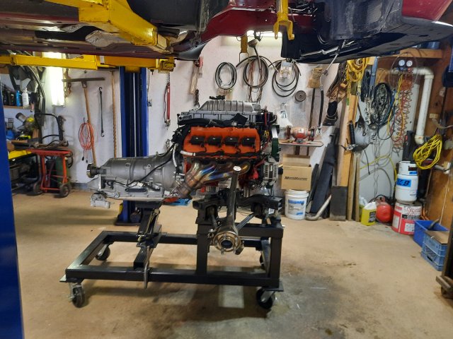

tomorrow I will drop the car down attach cradle an take a bunch of pics an measurements for anyone who wants to copy.;)
it works fantastic.
there`s a separate support for rear of oil pan so you can remove trans as well.

If you have access to a 2 post hoist.
This Cradle works like a charm for bringing the engine down from below.
You also do not need to remove your hood.
You would first let the k-member, engine & trans assembly hang from the car by loosening the 4 k-member and 4 transmission crossmember bolts about 3/8" out evenly, then let the car down just to make k-member contact the cradle, then raise the transmission scissor jack snug under the trans.
(Of course prior to this you have disconnected everything else to allow this assembly to come down.)
You then completely remove the 4 k-member & 4 trans cross member bolts and slowly raise the car making sure you have not forgotten to disconnect anything or that it might just get caught on something.
You can leave the A/C system sealed by just having another set of hands on a six foot by ladder holding the Compressor away from scratching the block and valve covers as the car is being raised.
What I did by myself was bungee cord it off to the side and placed a heavy cloth over that section of the engine and raised the car inches at a time then get up on the ladder and make sure the A/C compressor was sliding by nicely plus looking for any hang ups as I am bringing the car up until it was clear like what oilburners picture shows a few posts ago, then just roll it away.
@oilburner, @Hpindy and myself have used it now several times and would never do a removal from any of these LX/LC cars any other way after the first time we used it.
