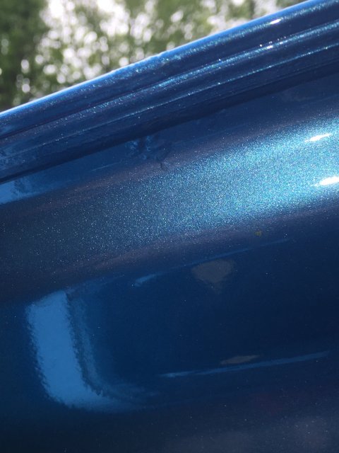

2016 challenger paint pitting on the hood.

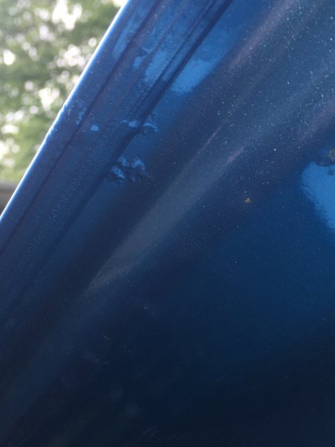

Looks to me like water got in under the paint somehow and caused it to separate from the hood. This is becoming an issue for sure as I’ve started to see a trend in threads about this exact situation lately. My guess is poor paint prep allowing this to happen. I’m sure we’re going to see more and more threads like this as time passes.
do you mean water got under the paint during the paint process at the factory? If so, would it take 5 years to show the damage?
The hood has had Xpel on it for the last 3 years. There was no tares on the film anywhere on the hood.

No I meant it looks a lot like when there's a paint chip and water gets in there. You have decent PPF protection so it may not be applicable to you. Could also just be like people have said about contaminants causing the issue. But normally even with that being the culprit there would need to be air or water to begin that paint lifting process imo. Otherwise contaminants would just be sealed in with the paint. Also the fact that most of these are happening on the leading edge of the cars points at possible paint damage from road debris to me.
Could also just mean poor paint prep and after time the paint just can't adhere any longer and begins to lift. Just my opinions which mean zero to my wife.

im leaning towards being an issue with the metal. Underneath the hood in that very same spot it looks much worse. Something must be going wrong with the metal when it is stamped at the factory, otherwise why would hoods, doors and trunk lids all be suffering from this issue in the same exact spot (edges of the panels).

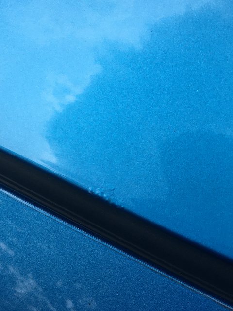

I got the car back today from the dealership.
They did a great job at getting rid of the blemish and matching the paint. I can't even tell where the issue was (I should have made some kid of reference mark). As expected, the dealership's body shop managed to find a way to do a sub-par job. On the underside of the hood, in the area where they did the repair, they left a minor imperfection.
It's barely visible, not sure how to explain it. Only way I saw it was because the service advisor called me and told me about the blemish. He told me to come look at it and if I wanted to, he would send the car back to the body shop to have it redone.
It's like a pimple, that is the best way I can describe it. I'm hoping there is nothing stuck under the paint/clear coat that will cause a similar issue a few years from now.
The blemish is so minor that I turned down his offer to have it redone out of fear that they might screw it up even more or find a way to damage something else on the car.
I'll try to get some pictures of it tomorrow, it's going to be hard since it's barely visible.

Wanted to update this one more time. I tried getting some pictures of the blemish on the underside of the hood but it's so minor that it doesn't show on the pictures.
After examining it closer I can tell it was caused by the clear coat. You can see the blemish is a result of a "run" in the clear coat. They must have sprayed quite a bit of clear coat, they sanded the top of the hood to get it just right but they didn't do the same with the underside.
