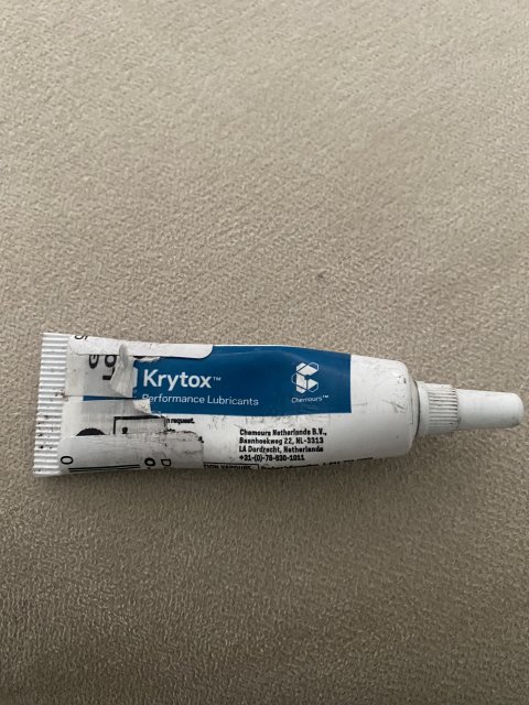

This is what @16GoManGoHC2 recommended to me. Said the dealer told him this is what they use. He and I have used it with no problems but it’s a little late now since you have the trans back together!
I searched and never found the torque values you’re looking for, so I just tightened them by hand until it felt good.
I think if I pull tranny again I’m going with no lube at all. Mantic recommends it to be dry as anything could collect dust and bind

When I lubed the input shaft, I cleaned the heck out of it, then wiped the grease on, then basically wiped it all back off. I didn’t clean it off just wiped it with a clean rag and I just left the thinnest of layers on it.

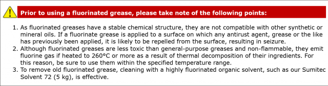

I'm not suggesting that the Krytox was the wrong grease for it qualities, but for its possible side effects and cost.

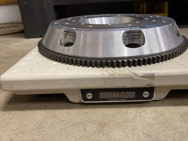

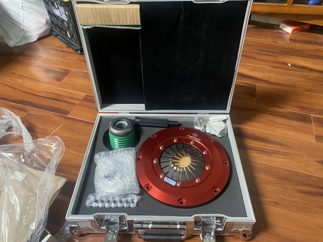

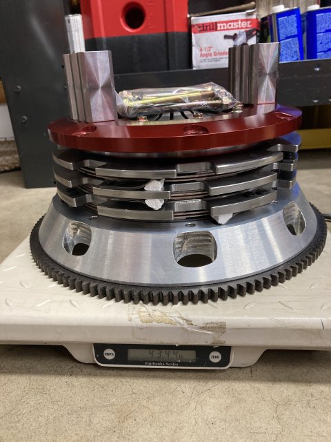

Finally weighed my Mantic triple, here’s its weight and the weights of a stock unit and a Mcleod RXT1200HD on a Ram Alum flywheel.
Here’s the Mantic and it’s flywheel
4633C719-A0B5-443A-A3F7-999E447BF1CF.jpeg DDC8ADB9-4B42-4974-BB5A-409D4D3DDD38.jpeg
Here’s weights on the stock unit and McLeod.
Stock clutch (38.44 lbs) and flywheel (23.50 lbs) = 61.94 lbs for the assembly
McLeod clutch assy (40.78 lbs) and Ram Flywheel (19.24 lbs) = 60.02 lbs for the assembly
Mantic clutch (31.82lbs) and Mantic Flywheel (11.62 lbs)= 43.44
So the Mantic assy is 18.5 lbs lighter then stock and 17.38 lbs lighter then the McLeod/Ram combo. Along with the Mantic clutch Assembly being about 4” in diameter smaller then where the weight is in the stock and McLeod setup and 18 lbs avg lighter then both should greater reduce MOI for quicker spool up and be easier on synchros in high rpm shifting by letting engine rpm drop off quicker off throttle. Unfortunately I won’t be changing my clutch out until my RXT1200HD gives up it’s ghost which may be a long while as it’s been doing fine so far.

~18lbs is a lot...
Maybe worth the effort...

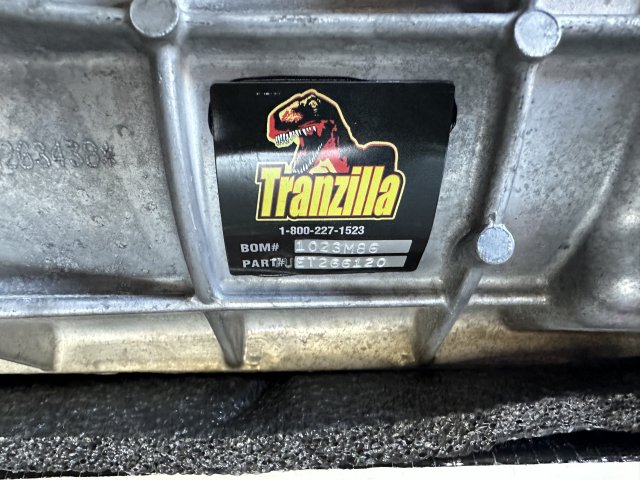

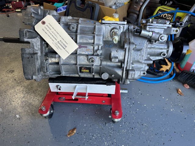

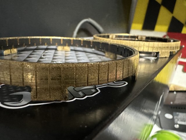

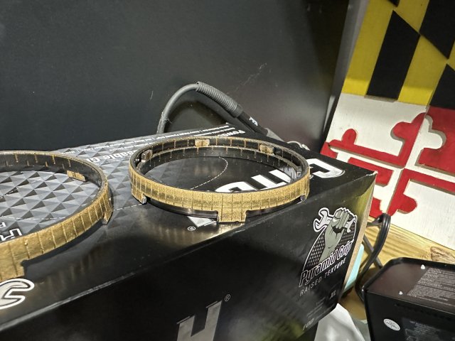

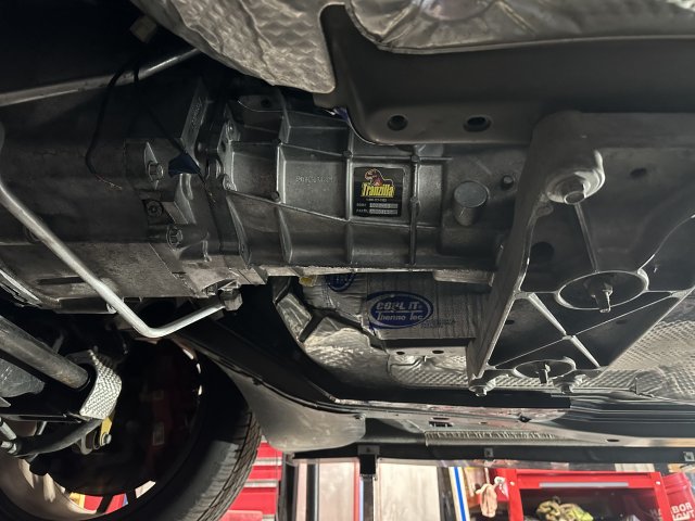

It’s been a long time I know but finally got this fixed. My 1st - 3rd synchros were bad. I gave it to Rockford standard and they changed the synchros and the gear ratio to 2.66 in first.
A little difficult to see in the pictures but that’s two of the synchro rings there, I should have it finished by tomorrow…..drove about 7 hr turnaround to NY today as I dropped it off rather than ship it.
Running RSG tranzilla synchromesh this time which they recommended. Looking forward to seeing the difference, and being able to shift the damn thing into third lol.
