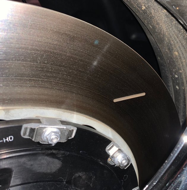

Picked up my factory ordered Redeye Friday 10/11/19. The front rotors only have one groove in them instead of many like on my old 2016 hellcat! Everyone else?
Wonder why?

Running change. It's normal. All '19+ should have them and if you were to get OEM replacement rotors for any '15+ HC they should be the same too now. Less grooves = less pad wear, and since most people aren't beating the hell out of the brakes on a road course it won't matter.

The new style is as good or better than the former and will (does) work as well on any road course in comparasion. Not to worry, they are a positive evolution in design.

I've noticed a significant difference in modulation with the new rotors, as in they have more bite but are also harder to modulate while driving on the street at "normal" driving mode.
