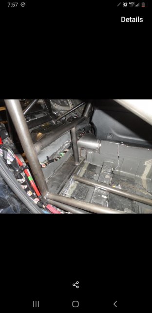

. I don’t think you’re seeing everything that’s involved with this. The entire underside of the car is reconfigured. There is a crossmember that is welded into the floor and a 7.5 second cert cage is tied into that. The cage itself is a part of support that the 4-link is attached to. You can’t weld the suspension attachment points onto the sheet metal. It would rip itself out of the car. The drive shaft tunnel is cut out and raised in the rear and the entire center of the floor behind the rear seat is removed and replaced with sheet metal to give the differential space to move. Also... you can see in the pictures there is no gas tank under the car. The 4-link uses that space. The fuel tank is now a cell in the trunk. That requires a metal firewall between the interior of the trunk and inside of the car. The seat delete doesn’t qualify. We are actually in the process of doing this to one of the shop Hellcats. It’s a huge job but if you want 1.1 sixty foot performance this is where that starts. B20F1B0F-01F4-499A-8E85-6C5D3761F304.jpeg
3,581
11,535
Here’s a picture of some of the floor work being done on a Hellcat to install the Drag Pak 4-link D4A8BE49-A5C7-49D3-82F7-ECB57EAEC54B.jpeg
