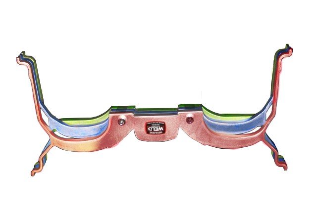

All weld wheels are made using 3 different centers, high, med and low pad and then by juggling inner and outer rings. Rings are in 1/2" increments until they max out. So you can juggle centers and outer rings as you please adjusting the width and backspace by 1/2". After you understand this you can design custom wheels to your own specs, like I did with the Low Pad 17X10 wheel for the Demon. They did not want to build them for me but I said I would be "responsible" for the fitment. You can build any wheel you want with their part number structure if you know how to break it down. They are not going to build a custom one off center for the Hellcat.
Thanks for the explanation. I follow it all except the high, med , low center thing. I never had that as a variable when I used to order wheels, don't know what that means or how it applies but I saw it on welds site when I looked at these exact style rims on there website @month ago. I've only dealt with width, backspacing, and offset.[/QUOTE]
In more detail. Across the whole RTS line they only have 3 wheel center blanks to machine from. So they machine all the different bolt patterns and all the different styles such as the S71 or S77 in any of the 3 pad heights to clear the brake caliper.
A Picture is worth a 1000 words.Wheel Cross section of Low (green), Med (blue) and High (red) pad heights centers......

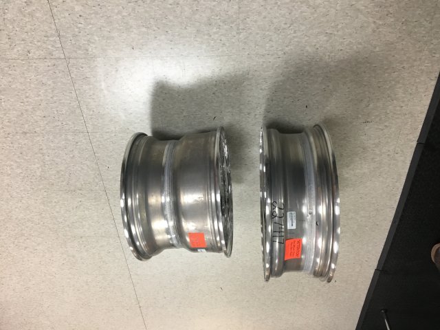

Do the rear wheels have knurled beads? Are you worried about the tires turning on the wheel?
HRJ
HRJ
#1045
478
1,043
Porsche GT3
Thread Starter #69
No knurles. Yeah, they’ll spin on the wheel but they don’t weigh near as much as a beadlock. I can have the tires moved back pretty easy here at work.

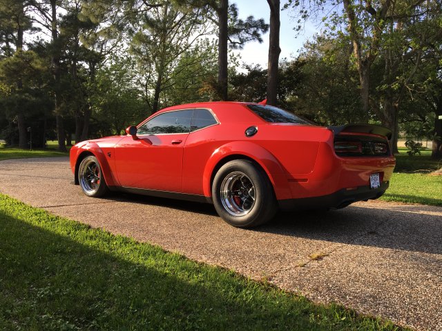

Random question, I’m looking to order those rear wheels. But when I’m on the weld website I’m seeing 17x11 6.2 vs 5.8, I’m trying to figure out what that is. Which option did you run? I’m looking for that exact look in the rear that you have!
10,584
29,877
#75
Welcome to the site.
Lots of very knowledgeable people here.
An old post, but someone should have your answer.
Under-Pressure
#20108
732
2,306
Space Coast
Stellantis 2dr
#76
5.8 was the backspace used on the OP’s car.
