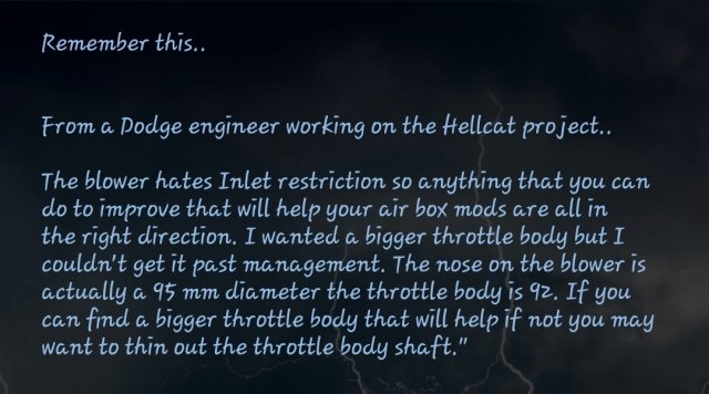

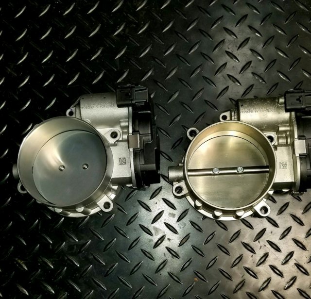

Fastman. He makes a 99mm for the Hellcats. He buys stock ones and opens them up. So retain the stock looks with added airflow. Screenshot_20200522-202002_Gallery.jpg Screenshot_20200508-175255_Messages.jpg

According to an old post on here or the other site a member dynoed before and after with a gain of 8hp and 39tq.

Just swap them out and reset throttle.

That would be me , on other forum. ;)
4,981
9,435
I think in most cases , just swap it out & should be fine. When I did mine I had no issues , worked fine but I did already have a stock tune when I did it.
You'll know right away if the throttle peddle works fine , if not there is a relearn procedure to do which I think comes with the FM TB.

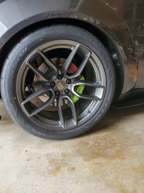

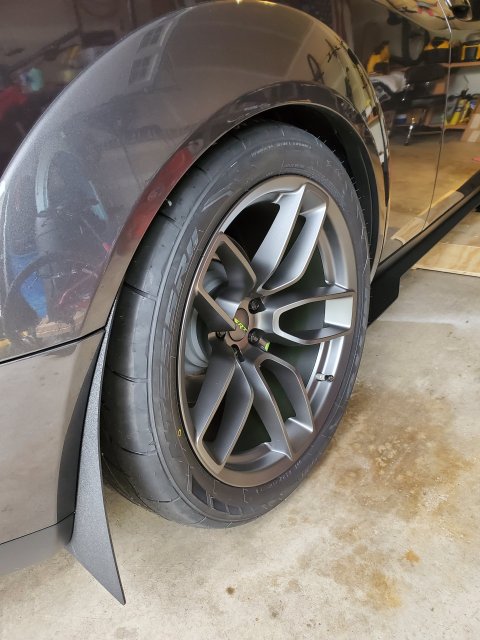

When it gets warmer these will be like glue! Almost even with the flare. Only concern was being lowered on H&R Springs but no issues. I have an extra set of WB rims so worked out well. I'm still in shock honestly. M6 is a Bitch in 1st & 2nd to hook and these look like that won't be an issue now. Much different car when you can actually put the power down.
