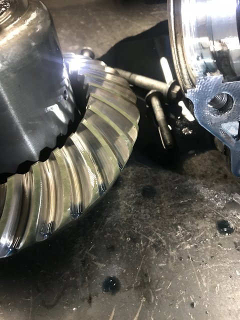

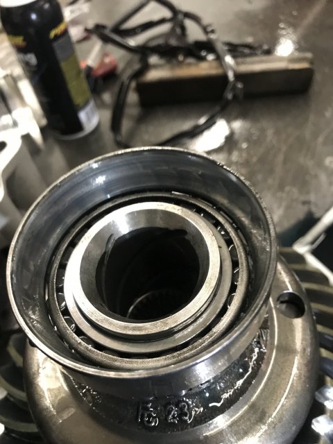

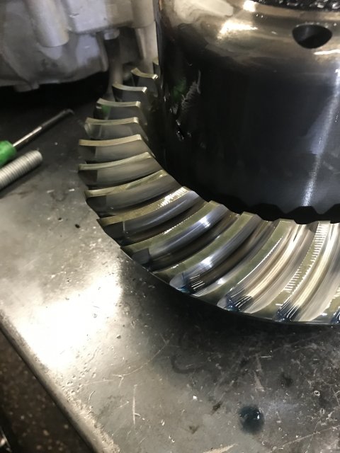

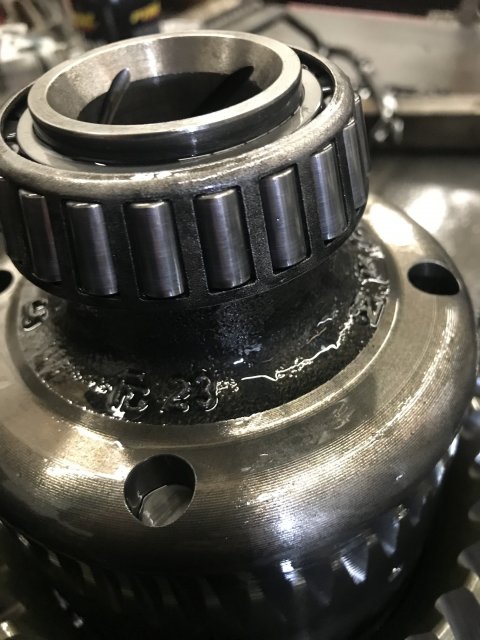

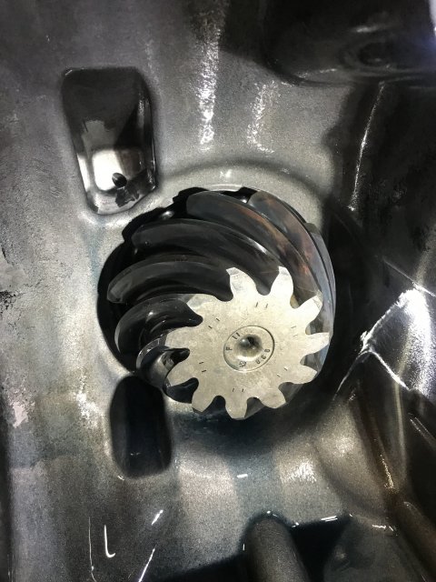

No longer for sale , I just drain it and saw fine metal in the fluid , so I will be disassembling it and see what’s wrong and fix it first
3,351
5,856
I removed the rear cover and it actually looks good I think it was just normal wear in the fluid hear some pics and the pinion feels smooth as silk 9F4DDB18-F290-4C81-8CEF-4CA55B2B64CA.jpeg B72F5580-A4A3-4303-B766-A5175CEDD99F.jpeg F88D8C08-CFB6-40D1-8F1E-34B86BAD41C5.jpeg 97FBBC17-15C7-4880-9777-2C84A837F1E2.jpeg 1F336F41-208B-4898-A34F-F38AA5E88A49.jpeg
