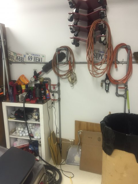

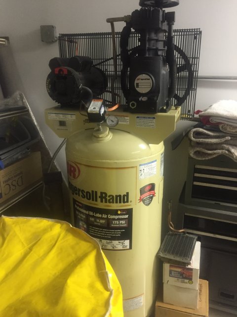

I have an Ingersoll-Rand 2 stage 5 HP 60 Gallon with 15.8 SCFM at 90-175 psi that I bought in 2004. You definitely want a two stage if you are doing any painting or media blasting. I used it for sandblasting outside with 1/2” line when I was doing some car restoration and now mostly just use it for my blast cabinet, some air tools, pumping up tires and cleaning things with air. Never had any problem with it in 16 years. I have a hookup for a 3/8” Line and one for 1/2” line when I need more volume like for sandblasting. I have a 60 amp breaker panel in the garage that is just barely enough to run my garage lights, outlets, air compressor and heat pump. image.jpg image.jpg

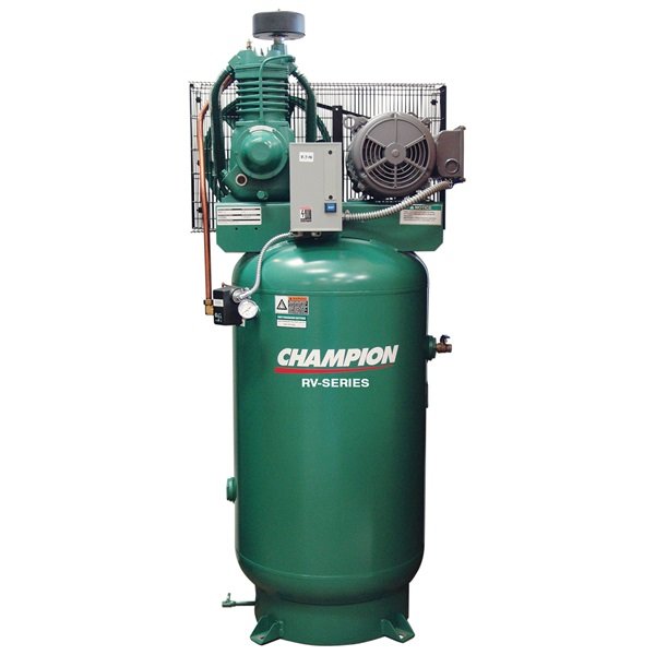

I’m using an older Champion 2 stage 80 gal. upright. Was 7.5 hp 3ph. But p.o. converted to 5 hp 1 ph. Has an automatic tank drain. Fairly quiet too. Looks like this.
