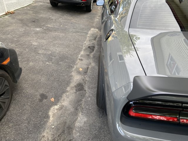

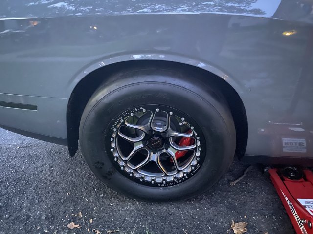

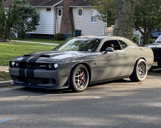

I purchased my Winlites from Carlyle Racing within a month of owning the car, and I have been running 305/45R17 since. I have the 3.09 gears in my car and I noticed 2 things. and I am not telling any secrets here. First gear was really, and it seemed that the car was shifting right before end of run. I knew eventially that I was going to put on 315/50's. During spring, I got a killer deal a new pair, and my 305 were wearin, but i I found someone who wanted to but them, and had the 315 mounted.
Well, they did not even come close to fitting.
I asked Ron, @DRAGRCR , and he pointed me , to his wheel well modification, showed him pics when I was done one side, and it looked really good.
However even after hot gunning, there was still a decent amount of rubbing happening
I later found out this was attributed to difference in offset between widebody(+demon) version, and standard body versions,

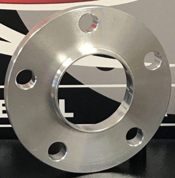

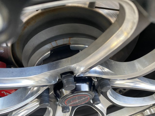

I ended up, and I am not a fan of spacers, buying a pair of 5mm spacers from US wheel adapters, but I added something to the order.
You can purchase the slip on spacer 2 ways, with, or without a lip. Since the Billet specialy whhels require a concentric ring, I had the lip made to fit the Bore of the wheel, and the bore of the spacer to fit the hub of the car.
so the 5mm wheel spacer looks like this, fitting tight to vehicle hub, and wheel bore.
I was able to get 7- 8 turns with lug nuts, no rubbing. I took the car on a decent run.

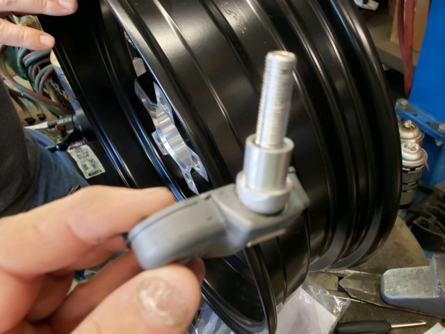

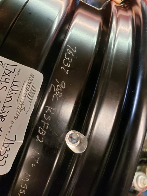

Here is what he texted me:
The original TPMS valve stem is machined down and re-threaded to 8.1mm. A spacer is made from aluminum with a groove at one end to hold the O ring. The wheel is drilled out to accept the valve stem. The original Billet Specialties O ring is used on the underside of the wheel; held in place by the new spacer. Two jamb nuts are used on top to secure the assembly to the wheel.

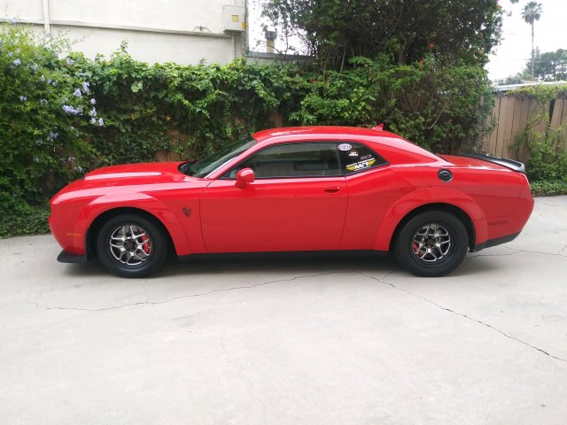

Stock SRT Caps? No. It's Gloss Black. It's a nice high quality finish.
