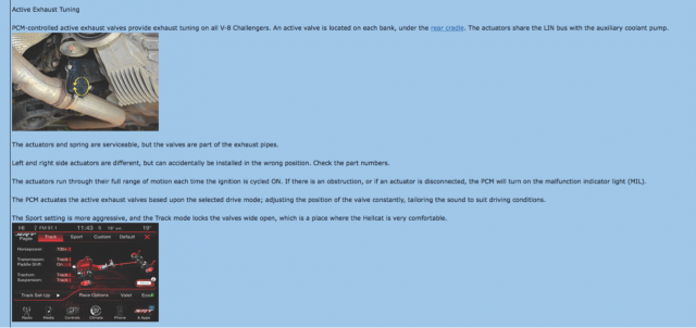

I believe I read somewhere that in track and sport it opens fully after you hit 3 MPH. I’ll see if I can find that article tonight.
Definitely notice the difference when its running in echo mode.
The sport setting is a little louder but track mode locks the valves open.
http://www.activeexhaustsolutions.com can help with keeping them open.

Reports are that on 2019+ cars the actuators can be unplugged and the valves secured open without throwing codes. Have not tried myself yet.

The valves fully open over 4100 RPM in any setting.. the car is a bit louder in sport.. but full track mode Transmission has a deeper louder tone than sport. You ever notice if you try to rev the car in park it stops at 4000.. and 4100 is where the valves come open.. so you can’t really show off hellcat exhaust notes just in park..

I love the active exhaust. It's nice and mellow while cruising but there when I stick my foot in the oil pan .
HarleyHetz
#1010
270
382
ARLINGTON
So when I put my BORLA on one of the wires wouldn't reach. Remembering this thread I left it disconnected. Got a code as soon as I started it. Cut the wire loose from the frame and plugged it in. Plan to erase the code this morning with my diagnostic tool as soon as it gets light enough to work outside.Maybe if I had left them both unplugged???
The BORLA has the active exhaust bypass where there is no valves, just a tang for the actuator to think it's actuating.
