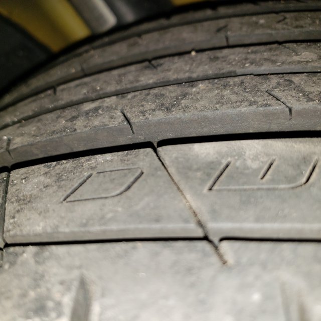

The HCs need more rear rubber, not so sure bout fronts. Many experienced people here have chosen the asymmetric setup with good results, so I went that. No rotation, oh well...performance over economy! As far as wear, I'm still early. Inside 2000 miles so far, but minimal wear so far. These tires have markings to denote remaining tread suitable for wet or dry. Grooves still look 20190903_231448.jpg sharp edged like new.
