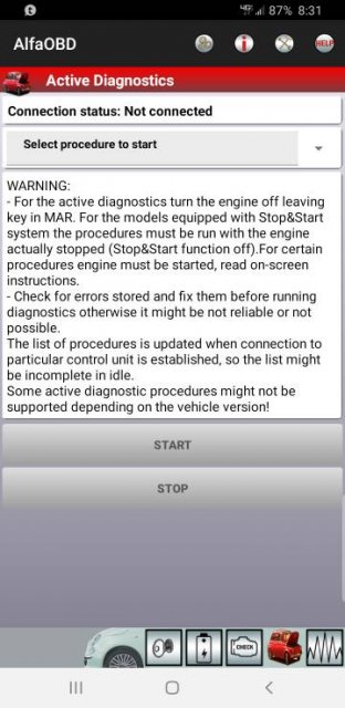

Here is a list if things you can put into TEST mode, to verify proper function.
This list will vary, depending on your model year and vehicle, but this will give you an idea of ONE of the things Alfa can do.

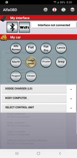

Launch AlfaOBD and choose DODGE/RAM, CHRYSLER, or JEEP. Click the bluetooth button and select your bluetooth OBD client, from the list.
Select your vehicle.

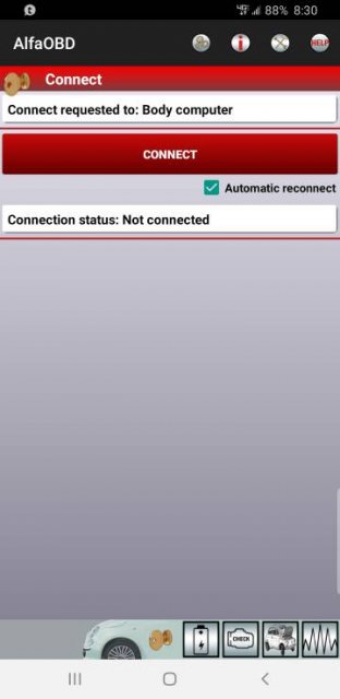

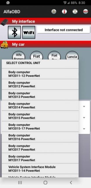

Select BODY COMPUTER.
Tap SELECT CONTROL UNIT and choose your MY Powernet.
Click CONNECT

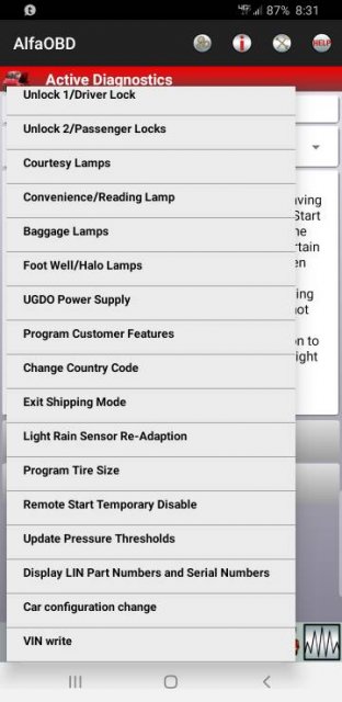

Click SELECT PROCEDURE TO START

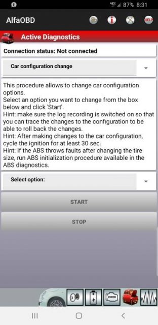

From the drop down, select CAR CONFIGURATION CHANGE
Click SELECT OPTION

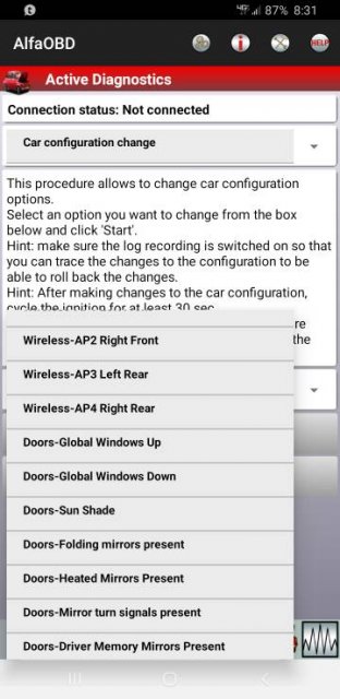

Scroll down to DOORS - GLOBAL WINDOWS DOWN
tapatalk_1567400575761.jpeg Select YES and click START once. In the information box, at the top, the current car configuration will appear. It will tell you if your car is set YES, or NO, or whatever variable you can choose from.
Click CONTINUE and wait. Alfa will tell you something like PROCEDURE COMPLETE and you can close the program and turn off the key, or push the start button to the OFF position.
Remove your OBD client.
Grab your FOBIK and try it out!
Enjoy!
