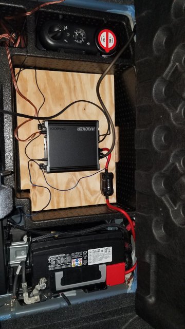

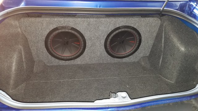

I purposely bought the alpine system because I wanted to build my own system. Got Kicker 3.5 in the dash, 6x9 in the doors, 6.5 in the rear deck hooked to factory amp. 2 12" subs in a Zenclosure box in the trunk. Kicker mono amp for the subs in spare well. Absolutely love it! Clean, crisp, and loud. Bumps when I need it to, full and warm when I don't need to let everyone know what I'm listening to. Simple Line Out Converter attached to rear deck speaker wires for sub amp. Remote wire tapped via Add A Circuit to Sunroof fuse in trunk fuse box. Spent hundreds less than the HK and had the pleasure of installing my own system. 20210314_145753.jpg 20210314_145738.jpg

Don't think I coulda done that when I was 20...;)

Looks great!
You can also use F12, in the rear power distribution block. This is the fuse for the cigarette lighters/power ports and is switched power, when in the offset position, like in the picture below.

2020 Challenger HC
Bob, that was my original plan. But after reading up on Littlefuse, many of these add-a-circuits are rated to only handle 10A fuses on each leg. So with F12 being 20A from the factory - I was a little hesitant. Still found a 20A add-a-circuit that I ordered on Amazon but while waiting I tried the 10A Sunroof fuse with the Littlefuse circuit I already had. Well it's been weeks now and everything is peachy keen. So I've just kept it as is and may use F12 for something else later

Yeah... remote turn on current is less than an amp. So...
Bob
Well, you know what they say. Safety first! It at least gives me a mental placebo
