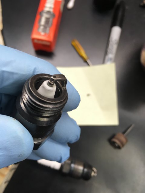

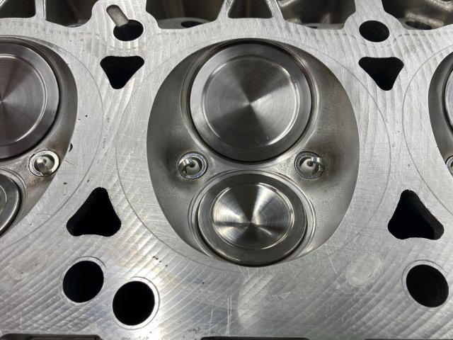

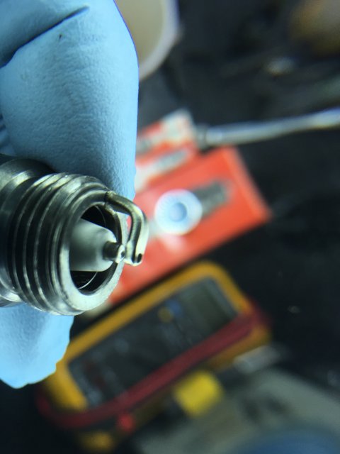

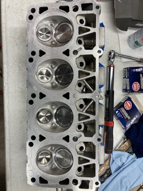

Index? Yes lol, me, always lol Facing towards the intake valve to cool the electrode and keep plug clean from shading of the electrode by the ground strap.
I’ve gone a step beyond and have drilled ground straps even to start the kernel and prevent spark blow out with nitrous lol

Hell we used to index plugs back in the 70's still do it on my bikes today

That’s awesome to see. I’m glad people still do it.
This isn’t shocking at all. It’s much more common on bikes nowadays than it is in modern cars. Glad to see that there are still people who can do it and are willing to do it.

Maybe it becomes different in a high boost application, but at least for NA setups Richard Holdener did experiments and found that indexing plugs made zero difference.

To me it’s more about electrode and ground strap cooling to help prevent detonation then grasping for a few HP as what’s 3-4 even 10 Hp in 1000+
