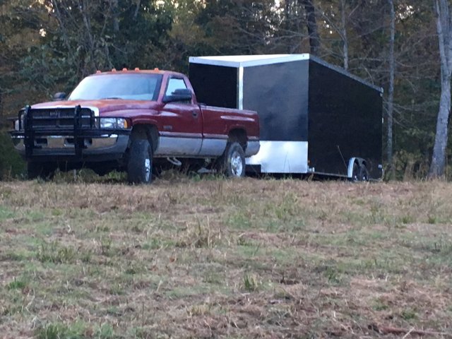

94 5 speed truck. My oil pressure gauge was everywhere, replaced the switch. I’ve had this old truck for almost 15 years and would sell my 19 dually before it

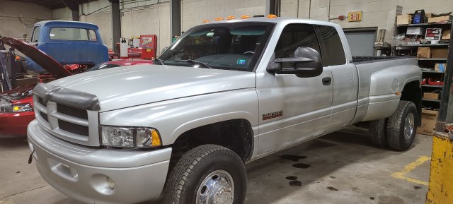

2001 24 valve 6 speed, just put 100hp injectors in over weekend.. i want a new one but just can't let this truck go!
I plan on a 6sp when it needs a clutch. where did you get your 6spd trans from if it was new?
