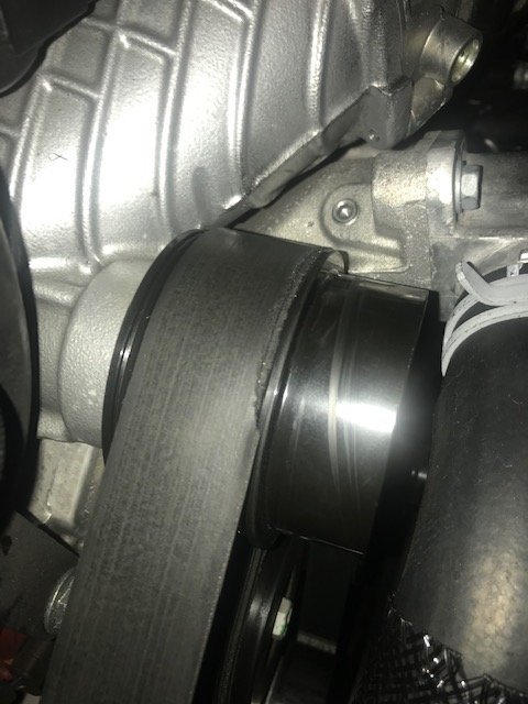

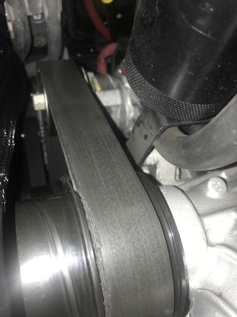

My blower belt was running on the edge of the blower pulley fraying the edge. I loosened the tensioner and positioned it back in the grooves. Now noticed a chunk is out of the belt. Saw something about Redeyes getting a stronger green belt. Did the Demon get a similar upgrade from the factory?

I have been keeping an eye on mine.
Nothing yet.

I've seen this happen to a few Demons.
It's not a belt issue, the snout stack up can vary car to car by as much as 1mm
