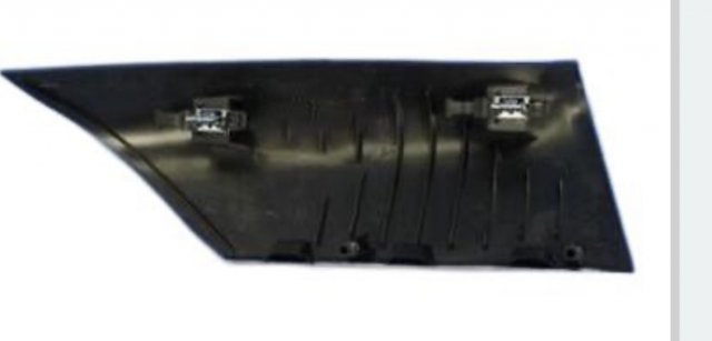

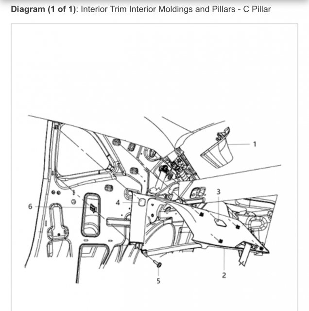

Is this the piece? If so, looks like some type of plastic retainer for the clip - not the actual clip that clips into the body - that piece is metal

I would just super glue it (jb weld) back together and put the metal clip back on it

Yeah, that’s the piece. I think the hoops are for the tethere. Doesn’t look like they sell them separately. I’d glue it or buy another one

He reported finding it on the other site, hopefully he'll give us the update here also. I asked for a better description in the title so when I break mine I'll find this thread in a search. I don't think it actually holds the C pillar in place.

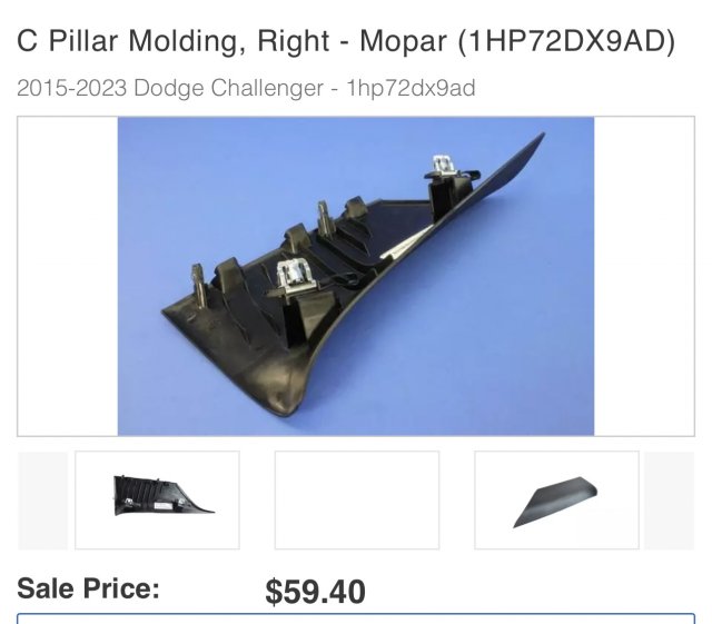

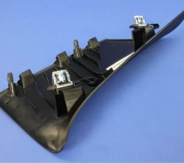

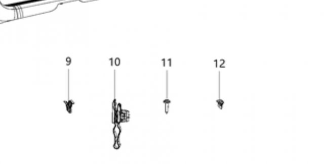

Looks like it’s #10 right here
7,730
6,539
55315143AA

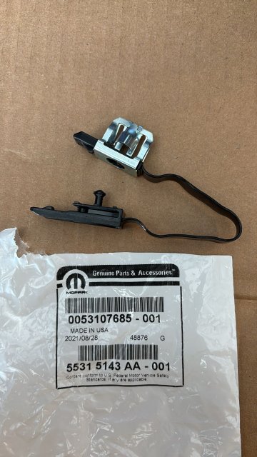

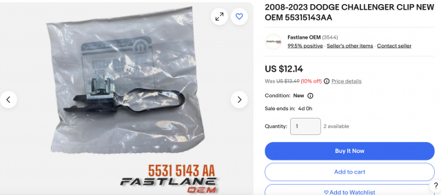

Never mind found it. Stealerships don't know what they're talking about. If anyone needs this like me here is the part#55315143AA. Different sites have different pictures but found one on ebay and it also has the other part of the clip with it.

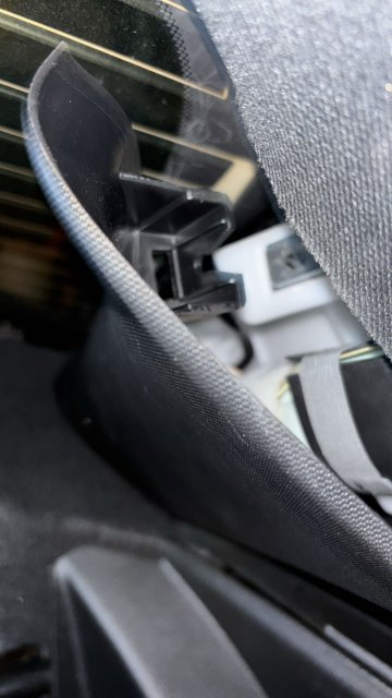

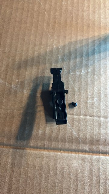

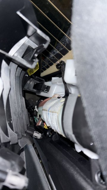

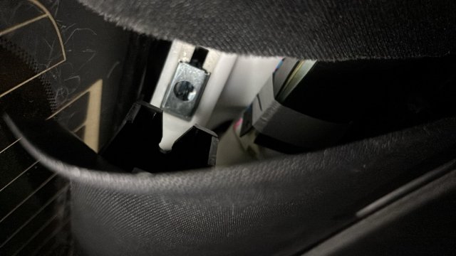

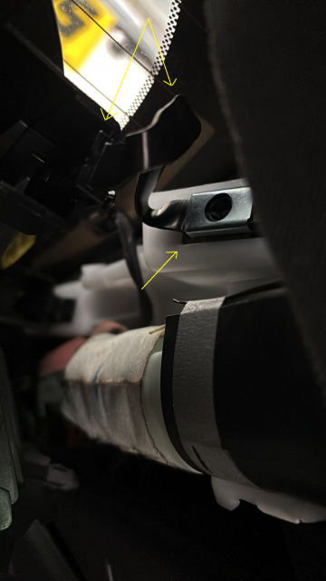

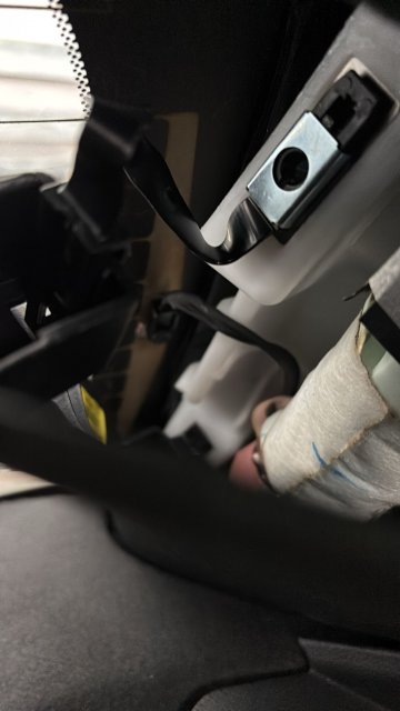

Here is some pics looking towards the rear window with the pillar pried open. The first pic you can see the second clip still attached. The next two are the plastic piece on the body that the clip sides into and then the plastic piece on the pillar that the clip also slides into. Then you push it together and hope the nipple goes in the hole and don't break it off like I did.

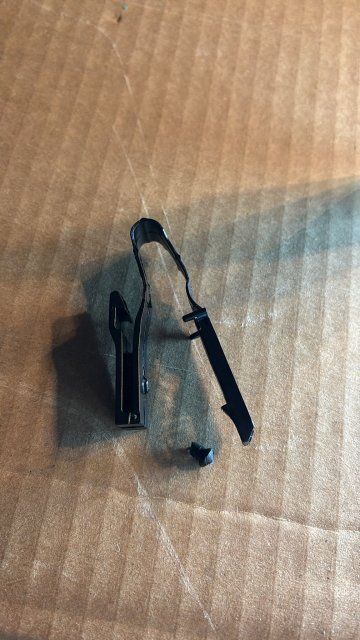

Just to update and a few pics of the clip and it is installed. You have to twist the "tether". It doesn't just clip up the way it is in the 1st pic.
