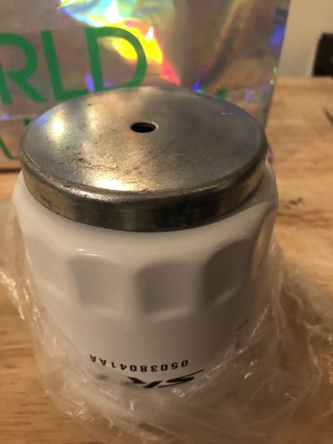

Found this magnet in my tool box, it’s almost the width of the bottom of the oil filter. Any thoughts why attaching this might be a bad idea? I’m certain it’s strong enough to stay on, it’s just not one of those super strong rare earth types. Appreciate your thoughts, thanks.

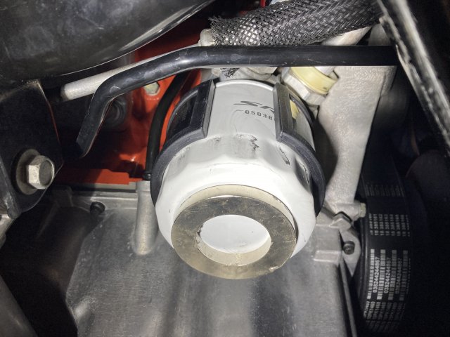

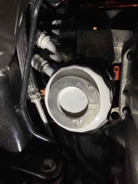

It’s probably going to come off first time you get on it. I have some like that on the flat bottom of the Moroso steel oil pan on my Capri and they end up at the back edge and hanging off always. I run these on the cat and the capris oil filters. I have a super strong doughnut magnet on the bottom of my filter as well and even it moves around a bit. D2FDB7D1-C8C3-470D-9102-69366B27F387.jpeg 53261F9F-C1A2-47C4-AC05-5B8F277BA44D.png D72A61BC-FE11-4B11-A0E1-8AC74BA6F6C1.jpeg
