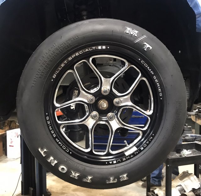

You need to use a different tire shop. My super light Billet Specialties Comp front runners and M/T Fronts weigh a total of 22 lbs (wheel is 10 and the tire is 12). 0FA8D8F7-24F7-43E4-9C59-4C0514B049F5.jpeg

You need to use a different tire shop. My super light Billet Specialties Comp front runners and M/T Fronts weigh a total of 22 lbs (wheel is 10 and the tire is 12). View attachment 119318

Haha. Why would I do that. Just saying… unless your fronts are lighter than that, you should be able to balance.
