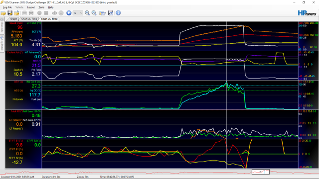

yes sir you are correct....I also think it's stock cam I have friend that has 16 just like mine and I know it's stock. But the problem mine having those lt headers and super 10 flowmasters it's so darn loud it's hard to tell.....but you can still tell there's not much lope it just sounds stock just loud. I think the tuner is having trouble with the fuels trims being to wacky acting....and A firend of mine seen logs on mine a couple month's ago and said the same.

Post up your logs, there are ones here that may be able to help. Also was wondering how your upper and incognito lower combo was working out as I’ve thought about adding a conservative upper to mine and have seen some others doing it.

I took a peek and I'm def no expert but does look like something is going on with fuel. I cant tell your fuel pressure or pump dc. @jonx96 @Hpindy @Speedy! @16GoManGoHC2 maybe can point you in right direction

Well I only had 5 minutes to look I have a meeting starting in 1 minute. Stop going wot your injector duty cycle is way to high. You need bigger injectors. I'm not in love with the lean fuel trims but they arent bad enough where I'm that concerned. Unless I'm missing it you need to log WB Lambda. I saw you hit 108% duty cycle. Scary

I'm just learning but the bypass valve looks to be opening to save things until the injector DC gets back to safe then repeat the process.
That is what my car was doing with no mods.
You should add the fuel pump info if you can.

In this state it is unsafe to keep doing WOT pulls.
Well I only had 5 minutes to look I have a meeting starting in 1 minute. Stop going wot your injector duty cycle is way to high. You need bigger injectors. I'm not in love with the lean fuel trims but they arent bad enough were I'm that concerned. Unless I'm missing it you need to log WB Lambda. I saw you hit 108% duty cycle. Scary
It got worse he went full on pop piston mode 117%. I am attaching channels you should log. You are missing some fueling components that will help you determine how stupid lean you are (which you are). Now this goes with a caveat. Some channels on my PCM may be different than yours, you might have to go back into the channel editor and go find them again. Also I am perplexed as to why your pressure ratio is 2.17. That is way more than stock boost. (2.17 * 14.7) - 14.7 = 17.199lbs, can you send us a picture of your pulley and crankpulley/dampener?

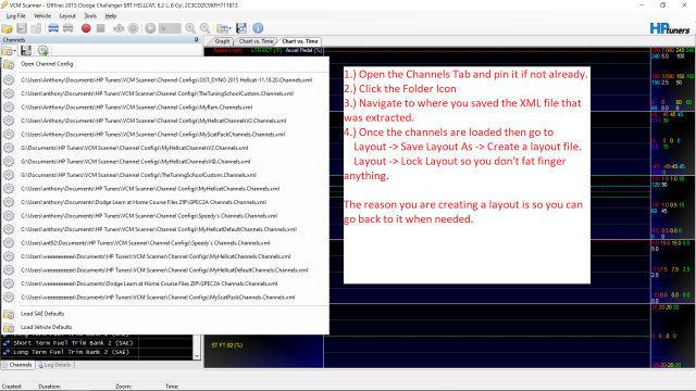

I keep trying to add what you sent but....I'm not computer savy. I downloaded it but cant figure out how to get in on scanner

So to load the file I gave you, please extract the zip file to a location of your choosing, Desktop or My Documents, make note of the location. Then open VCM Scanner, do not start logging.
