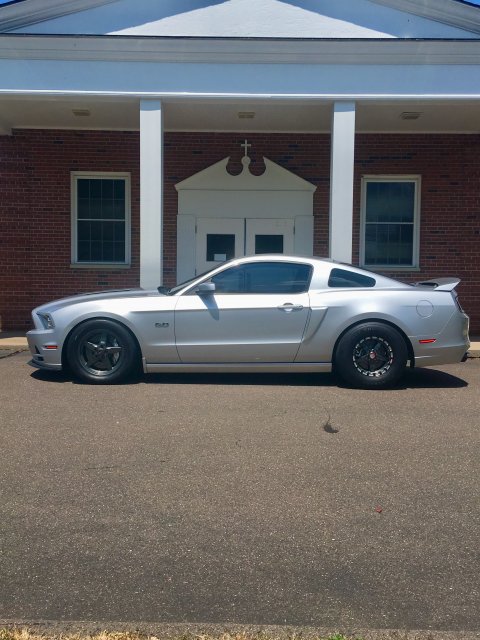

15's just give such a badass look to. Here is a set of my Mustang I have the Baer stuff front and rear now so I could run the RC Componets. Dont have pic of those tho but they are on now and they are super light.
