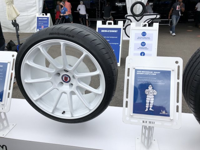

So if I want tires for a course like Sebring but are usable around town is the answer Michelin Pilot Sport Cup 2? Talked to a rep there and that was his reco but he doesn’t rep for other manufacturers. My Dodge tech also highly recommends Michelins. Any thoughts on stock 2019 Redeye wheels for track days? Finally, when looking at the 305 20s for the Michelins I see several variations that say Ferrari, Jag, etc. Which would I choose?? Thx!! C0590B1F-617C-4F00-8AA5-21644BC14479.jpeg

In a 305/35 tire you might be best served to just get a PS4S tire if you're also driving it on the street. It won't be as fast as the current crop of track tires but we are talking about maybe 2 seconds per lap on a lot of courses. Unless you've done a lot of track days and had some coaching you're better off spending your time and money on those 2 things.
If however, you're looking for that competitive edge I think the only 2 to consider are the Toyo R888R and the Michelin PS 2. Normally I see the Toyo cheaper but it makes a lot of road noise that gets annoying at highway speeds on the street. The PS2 is a good tire that DGatzby has good experience with.
For a 200TW tire that will be better than a PS4S consider the Goodyear F1 Supercar 3. It comes in a 305/35 and the Camaro guys love it for overall performance and longevity without heat cycling out very quickly.

Thanks @TrackDay I have had some coaching but perhaps my first set is a PS4S and then I can see how serious I’ll be and consider moving up from there. Appreciate it!! Are my stock wheels sufficient?

I agree with @TrackDay. I will be using what remains of my 305 R888R’s in May. They have produced good lap times. I hope for a bit better. IMO they rumble and sing loud to my ear, but they do perform and wear well. I will probably open up at BIR on May 3 with these in the first sessions of the year FYI. Saving a new set of Cup 2’s for after lunch.
On the Michelin side, like he said unless you have a real good reason, try the PS4, PS, PS4S. The Cup 2’s are spendy and can be soft/wear quicker than these other tires. Also, they are more sensitive to getting warm to optimize performance. It may be more easy to warm things up at Sebring, than sometimes in the early mornings here. But try their other models before you dive into the Cup 2’s. Especially if you are just getting into road coursing a Hellcat. If you don’t have all your alignment settings perfect up front a journey down the road with Cup 2’s could scrape their outside shoulders off quickly (mine did that). Even driving straight ahead. Also, I agree, they may not net a lap time that much better in our cars than other competitors that are close that I have not tried myself.
7,787
48,980
Yes. The OE wheels is what I have the R888R’s on. They work great.

So if I want tires for a course like Sebring but are usable around town is the answer Michelin Pilot Sport Cup 2? Talked to a rep there and that was his reco but he doesn’t rep for other manufacturers. My Dodge tech also highly recommends Michelins. Any thoughts on stock 2019 Redeye wheels for track days? Finally, when looking at the 305 20s for the Michelins I see several variations that say Ferrari, Jag, etc. Which would I choose?? Thx!! View attachment 40026
I have to agree with Trackday here. For the street and for some road course use the PS4S is a really great tire. I use 295s ps4s rears on my Charger on 10.5s Reps.. They warm up relatively fast and stick very good above 45-50 degrees. If you want the best performance on the street in your Redeye Though while having a decent tread life with spirited driving I’d recommend Nitto 555R2. These tires really hook well and continue doing so even being worn in a couple thousand miles. Currently I’m using 315/35 Nitto555R2 on my Redeye rear stock 11s.

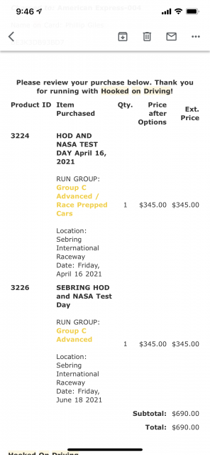

@Rcasa20 Rico, when are you going to Sebring?
I’m signed up for two track sessions at Sebring.
No date yet. Need to get my tire situation settled and will keep you posted.
