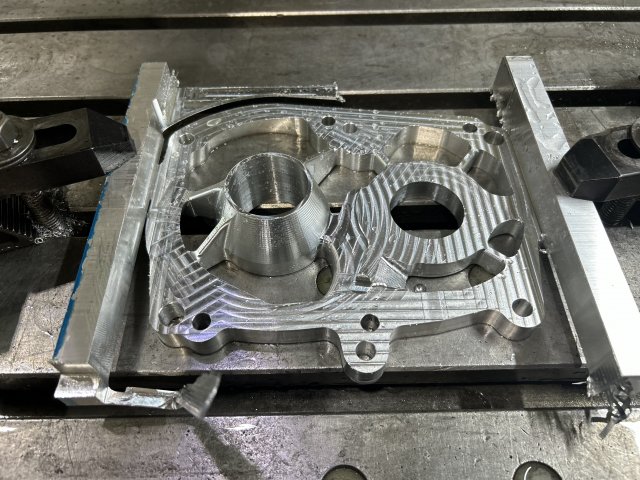

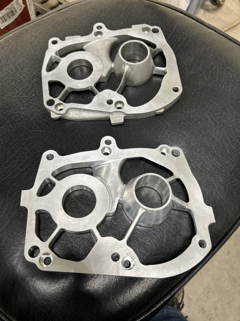

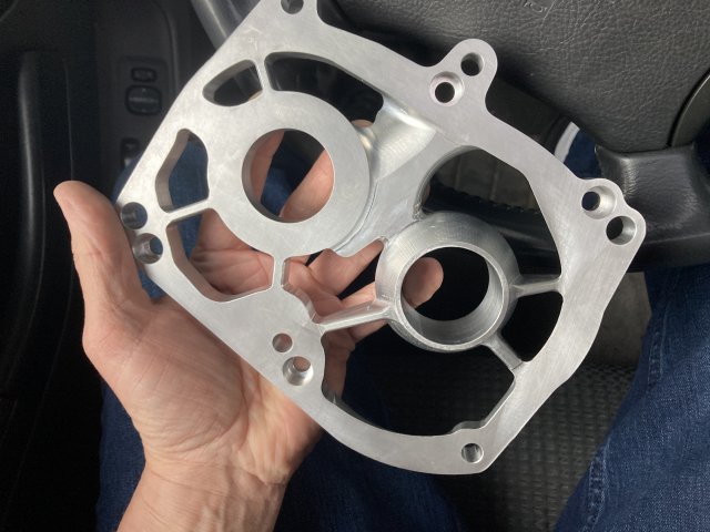

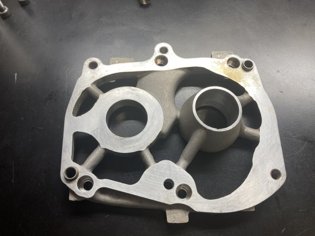

Finally have my billet inlet plate for my 2.7 IHI completed. Made from a block of T6061 T6 aircraft grade aluminum. Precision machined to within a few tenths of a thousandth of a stock plate. Can make a batch for sale if I get enough purchase inquires for them. Will be dyno ing what kind of power it makes soon. Top plate in one picture is a ported stock cast plate that I used as my template. Stay tuned!!

....dammit boy that's pretty!

Thats freaking badass bro..... Id be interested in one of those they make em for the 2.4?

No just the 2.7 at the moment. I only made it because I couldn’t buy one that I liked, the SDG I liked but he would not sell one to me for self installation.

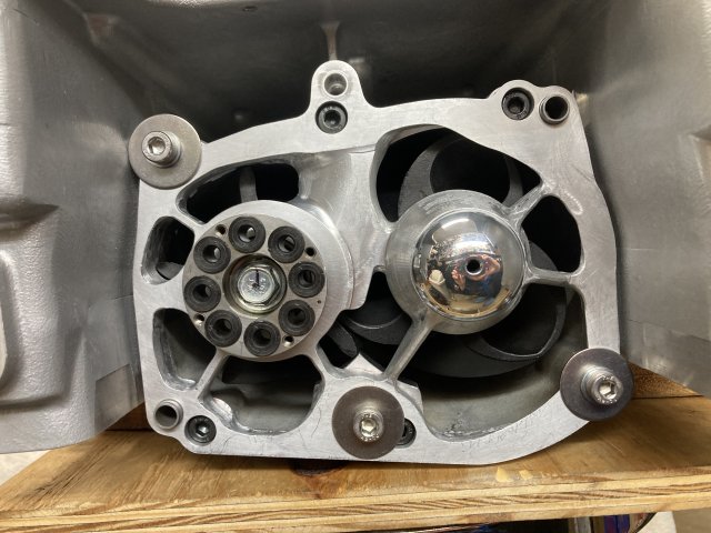

Compared to a stock unported 2.7 plate, much more open but MUCH stronger. I could have taken a support or 2 away but I plan on spinning this 2.7 with a +10 ATI lower and a 2.86 Satera clutched quick change upper pulley and my engine sees 7200 rpm between shifts so at the moment I want maximum rigidity of the bearing supports over maximum flow potential.

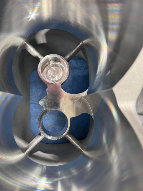

37k RPM peak on that male rotor. That's really spinning.

Glad to see you didn't mess with the rotor timing on your billet plate. Should make power all the way through instead of just top end.

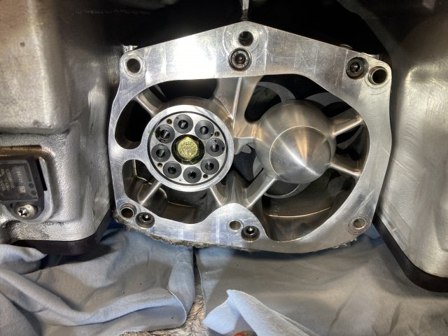

Port matched plate to snout and opened snout up to 108mm. Heated plate to 275F for an hour and it dropped right on the bearings and dowels, perfect fit. Checked rotor relation and timing, looks perfect. Coupling is pinned to the rotor shaft, have to do the same to the snout. Filled with 8oz of Jon Bond blue ceramic super charger oil, be time to put it on this weekend hopefully.
