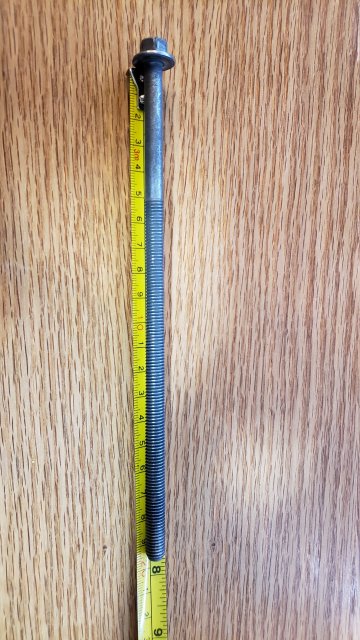

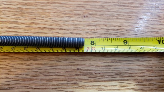

I put 8.5" stainless steel threaded rod in with my spacers instead of bolts. And stainless steel flange nuts at the top. Not worried about pulling threads out of my head's any more.
Where did you get this from , links ?
Pics please ?
Sizes & Cost ?
Thanks.
Pics please ?
Sizes & Cost ?
Thanks.
I'll take a picture when I get home
Any update on this? Getting ready to install my kit Soon.
