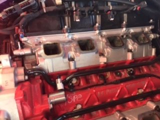

Since I got my Redeye I’ve never seen it go more than 11 lbs of boost. Last week we installed the SC spacers and thermo blanket.
I noted when we removed the SC there was some evidence of blow by on the right bank. See attached.

Damn, that’s nice!!!! You think sealing that off lead to regaining a lost 2.5 lbs of boost, seems a little optimistic, no?

I did the exact same run with very similar conditions before installing the spacers and blanket so.....
I think I was loosing boost due to the blow by. The car is advertised at 14.5 so...

If it spec’s at 14.5 I guess the leaking was a little worse than apparent? Either way good for you, that’s great!!! Found hp is always a winner.

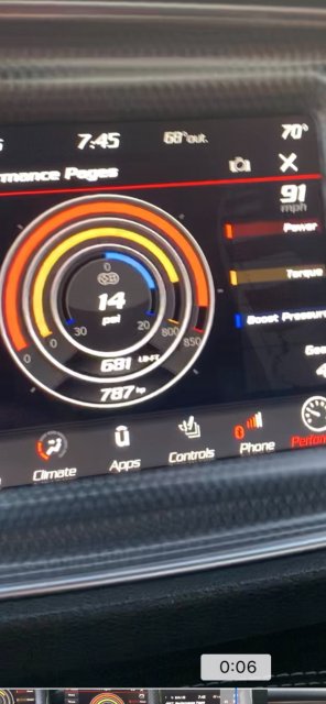

My RE coughed up these numbers last summer one evening, doing a short romp, you can see the temps etc.....

WOW , nice , I've never thought about it until now , but are those hp #'s at the crank you think ?

Well I think @Speedy! found an algorithm table, where it does the readings based on the boost. So looking at this, if it sees another 1/2 lb, it probably will show the programmed max.

I’ve never turned that page on 😂
I have maybe 2 or 3 times , never payed it much mind , didn't think it was very accurate ?

I was out alone, just playing around with it on a real nice evening and was curious what it was reading if I stomped it because it was feeling good. I admit one hand on the damn wheel and another on the phone, that is how easy these can be to get yourself in trouble with.

Yeah , I guess that is crank hp because when they advertise HP it is crank hp.
