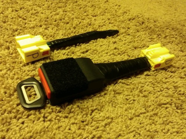

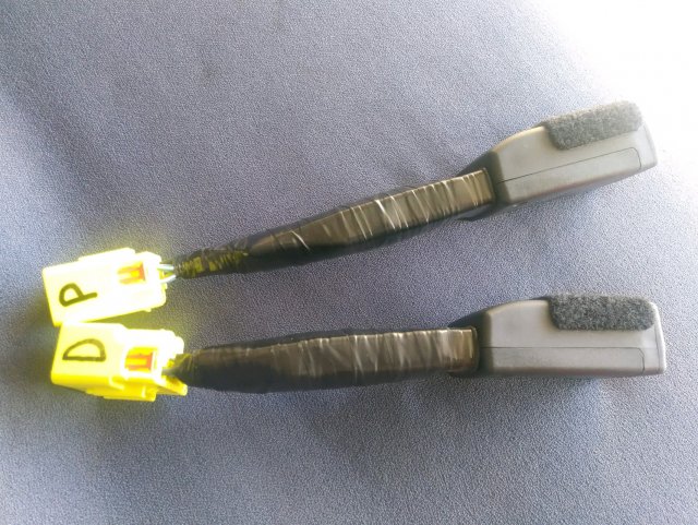

I took the info that Pete posted in the other forum and info I learned from members buying full on Hellcat Harnesses for me to cut apart and learn from, and now I can now make bypass harnesses for 2015 - 2019 both Pass and Drivers side. I am now making them with all resistors. No seat belt buckle needed anymore. So, they are cheaper to build and more compact. I also make the Windshield Washer Bottle level foolers if someone wants one of those. All this does is make the AirBag light in the dash go out. So, if you are like me and do not like warning lights on. The main reason I got involved in this is because you may not pass Tech at some tracks with your AirBag light on and my Friends and Forum Members were asking me to make them. My local track, Irwindale, will not let you race with the AirBag light on.

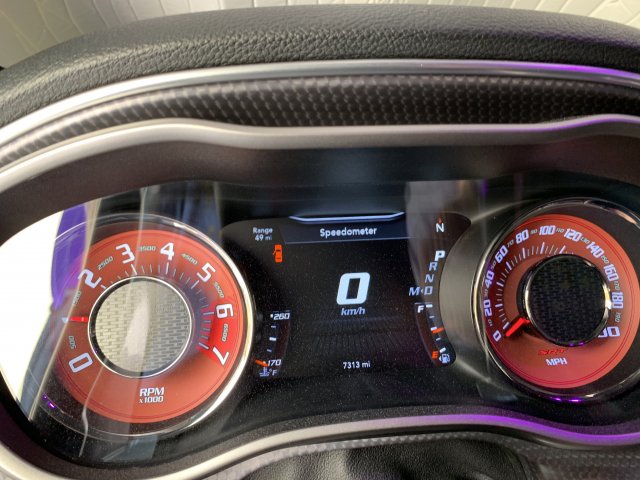

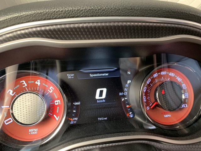

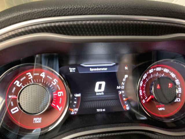

Ok I think I have one of the first sets of bypass harness‘ made by Ron for the 15/16. I tested both my 15 HC Charger and 16 HC Challenger in the same manner.
step 1. Start the car with everything connected in factory settings. Allowed the airbag to self test and light went out
Step 2. Unplug both factory harness from the seat and start the cars. I let them run for a bit
Step 3. Plug in both bypass harness’ start the car and let run for awhile. Airbag went out in normal time.

why is seatbelt light on in pic 3 ? …..does it stay on with bypass plug ?
I didn’t have my (drivers) seatbelt fastened. When I fastened it the light goes out.

Did you do the bypass plug for both seats or just the passenger seat ?
Thanks.
I've tested with just the passenger seat in “bypass” mode, and driver seat factory. When seatbelt fastened no lights

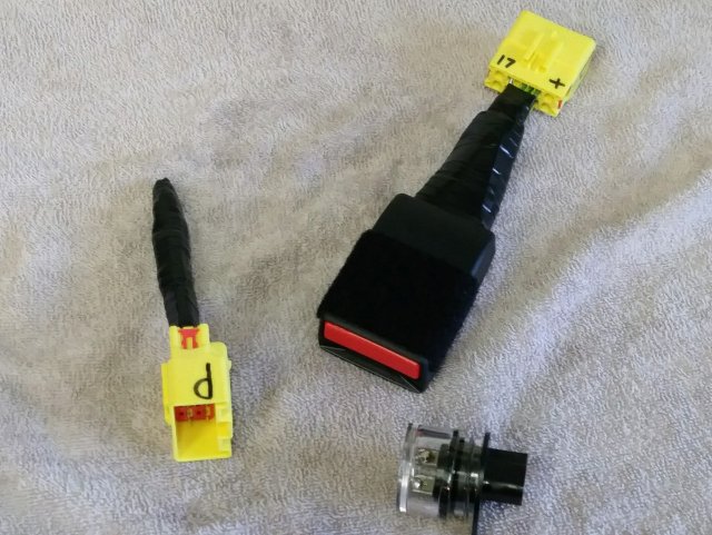

srtdusty has been very helpful with feedback and testing these. So, what we discovered is that I am able to fool the Pass side with all resistors. No buckle needed. The car is happy with resistors where the buckle is. So with the Pass only all resistors you will not have an airbag light and you will not have a seat belt light once you buckle the drivers side seat belt. BUT : I have not and probably never will be able to fool the drivers side seat belt. Because there is a difference in what the car wants. For the passenger side the bypass is making the car think there is an unoccupied seat and can be fooled with resistors. For the drivers side the car wants to see a "buckled seat belt". The difference is the drivers side does NOT have an occupancy sensor. A person present in the drivers seat is assumed. Duh! The buckle has a Hall Effect sensor and it cannot be fooled with resistors. As far as I know the Module in the car applies a voltage on the buckle circut and is looking for feedback of some sort. Also polarity on the actual buckle circut does matter. So, another thing that can go wrong.
srtdusty's second set going out (this set should take care of the seat belt light from the drivers side) and one other members set just finished.
