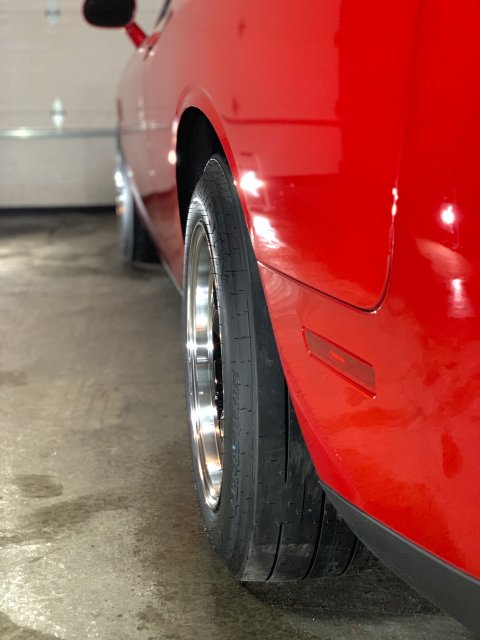

Thinking of going with either of these 2 from Weld:
RT-S; S71; Size 17x11 in.; Bolt Pattern 5x115 mm.; +5 Offset; Backspacing 6.2 in.; Black Center; Polished Shell; Bore Diameter 3.18in./80.772mm.; Center Cap Included;
SPECIFICATIONS:
OR these:
RT-S; S71; Size 17x10 in.; Bolt Pattern 5x115 mm.; +30 Offset; Back Spacing 6.7 in.; Black Center; Polished Shell; Bore Diameter 3.18in./80.772mm.; Center Cap Included;
SPECIFICATIONS:
With the Phillips Flares it would seem I can go an inch or so outward than I would vs. the standard 1/4 panel sheet metal without looking like the tire is poking out too far. I know alot of guys run the 10 wide rim, but if I can get away with the 11 and not have to mod the ribs in the wheel well, I would be happy with that. I've already modded the plastic liner a bit, and am currently running Nitto 315 NT05r's on PK's HR5's that are 11 inches wide, with a back space of about 6 3/4 or so.
I just want more sidewall to plant the car a bit better. Wiles D/S went in a few weeks ago, in addition to a few rear suspension pieces and the BMR Cradle Lockout Bushing Kit that were installed last year.
Thanks to all...
