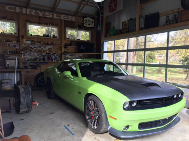

305/35/20 20x10.5 rear and 285/35/20 20x9.5 front. It's an awesome combo. But I'd lower just a tad. I went with Eibach Pro's for just the right amount of gap removal. I feel it's the best look, and I have not had one issue. I drive the crap out of my Cat. It's far from a Garage place holder.

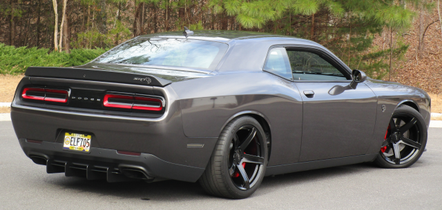

285 front, 305 rear for comparison.

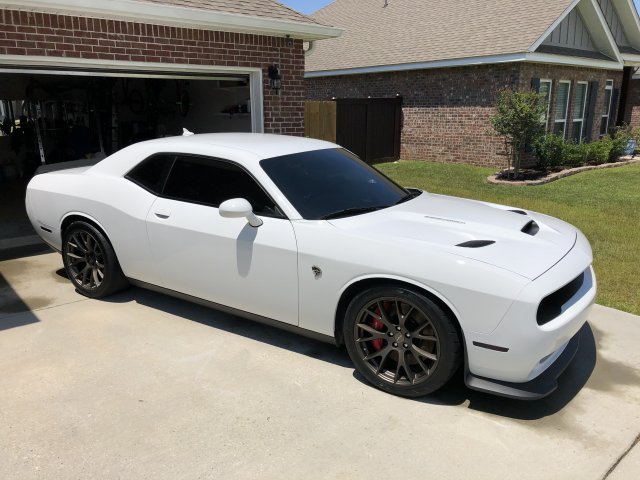

275/40’s up front and 305/35’s in rear. Not much gap.. I’d like to lower with mopar springs but would probably end up scraping my driveway🙄

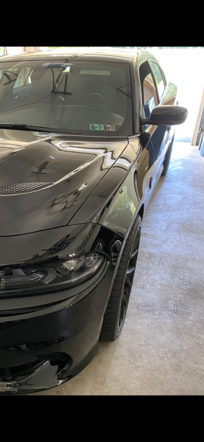

I have 285/35 Michelin ps4s front and 295/35 Michelin ps4s rear on 10.5 repos on my Charger all the way around. You don’t want any bigger than 285 up front if your talking about the charger non Widebody.. 285 already stick out a bit from the wheel fenders but not so much that it looks off.. 80B77EAF-5AC4-4084-BBD3-3CC34F3C2055.png 2AFDC05E-2301-4B04-96AB-5A04D0302C98.png

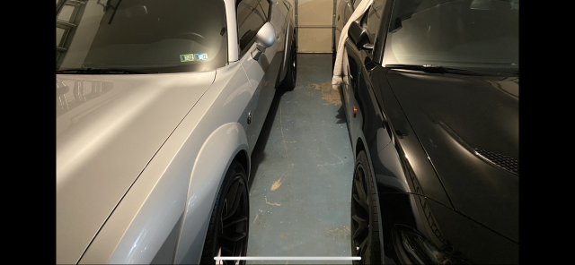

I run 295/35 all around. The Michelin’s as a brand are wide compared to others but don’t poke out sitting pretty inline to inside with the top of the wheel arch. This pic I have the dr’s on the back and the rear tyre off to the side . BAE23436-D7F9-4105-AB96-2A13E05740F6.png
