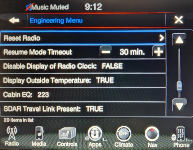

I forget the radio button sequence for accessing the engineering menu that allows for a couple of different levels of radio reboot.

Let me go see if I can figure it out, it is some combination of UP/DOWN MUTE button while turning power on.

With ACC power on, press and hold Driver's temp UP/DOWN buttons, after 10ish seconds the Engineering menu pops up, then scroll down to Reset to factory default.
I'm not sure I would do this until you've exhausted everything else first though.

^^^Do you know if that works for all years? I would love to try to get mine reset to get my best times back in my performance pages
I don't know, I'm checking on my other two now

My Challenger is a MY16, worked as described, my DSRT is a MY19, I could not get it to work, perhaps it's a different key sequence?
My Power Wagon is a MY17, and it worked
Thx for checking, must be something different for '18 or '19+ models. I saw a youtube video that just said to touch the top left corner of the screen until it resets, but it didn't do anything for me.
