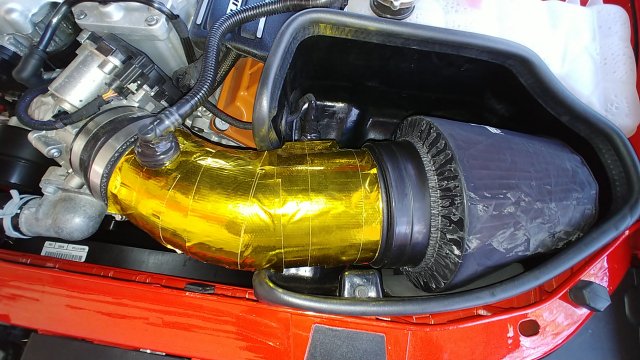

I replaced mine (a 19) with a JTL.
Much cursing. They aren't made to go on 19's.

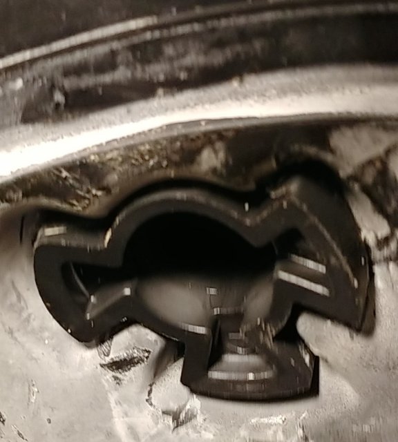

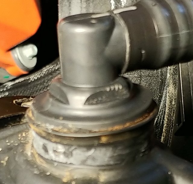

The part not made for 19 CAI's.
9,054
23,898
What the 19 stock CAI looks like.
And what it looks like on inside of tube.
Have to cut the ears off to fit in the JTL tube.
