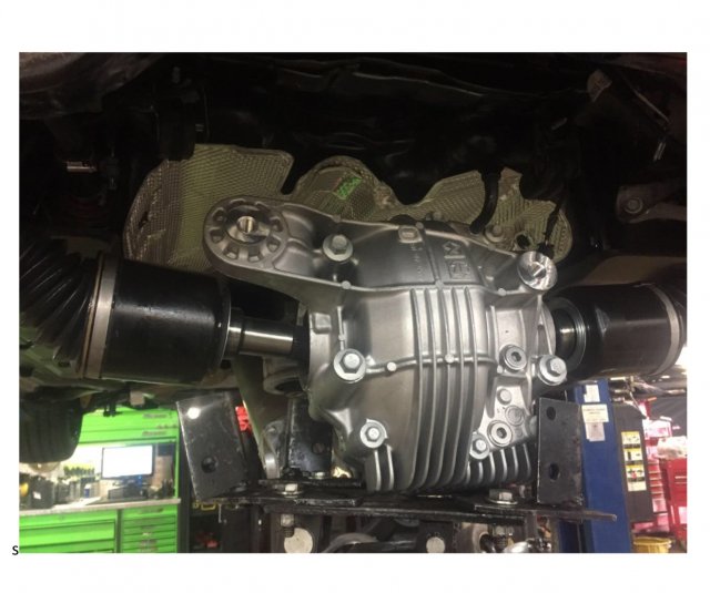

I'll also try to post up a picture of the plywood cradle I made that will help bunches too.

I put up a picture here Bull if you don’t mind draw two arrows to where you are saying to place the pry bars.

One one the front side, one on the rear, so one one either side of the axle.

I popped out 1 axle at a time so there's more room to push the diff the other direction to get the axle out easier, then do the other side. For reinstalling the axles, pop in one side at a time also, pushing the diff one way or another to line up axle & pop it in.
I have a 8"w x 10"L channel iron piece that bolts to my floor jack, for lowering & raising the diff. , place some rags or towel to protect the diff & from sliding.
NOW I GET IT !!!!! I am prying on ONE AXLE at a time, BUT using two pry bars at the same time on that axle to be able to pry out evenly!
