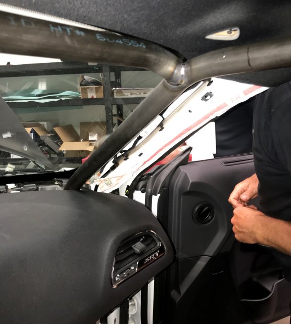

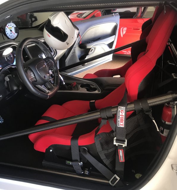

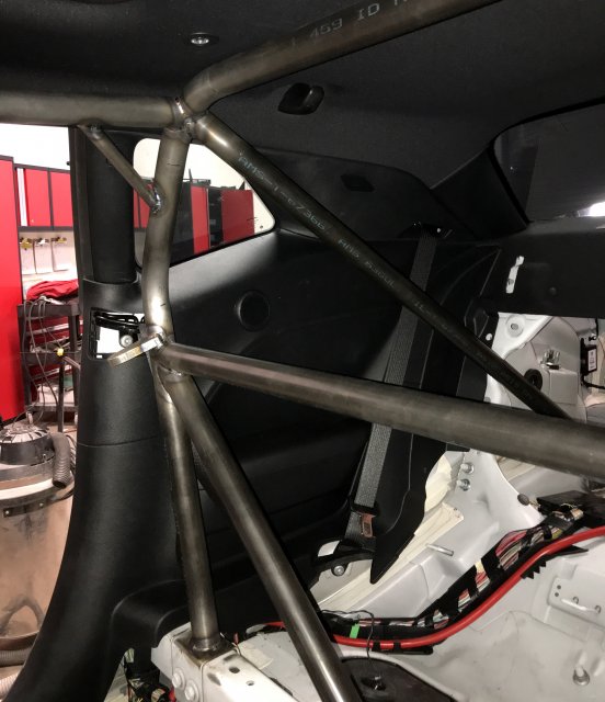

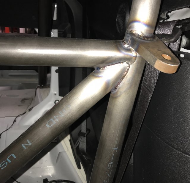

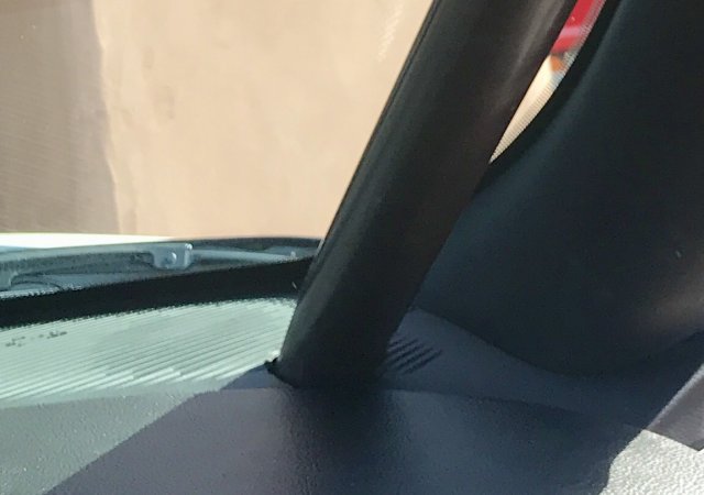

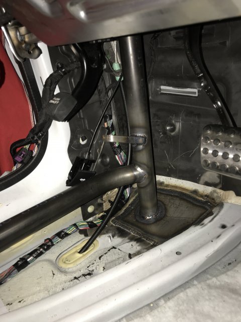

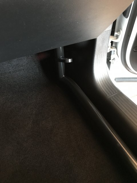

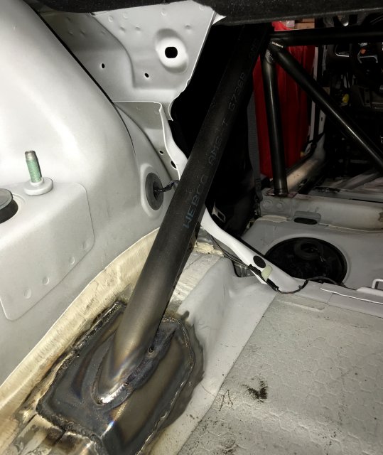

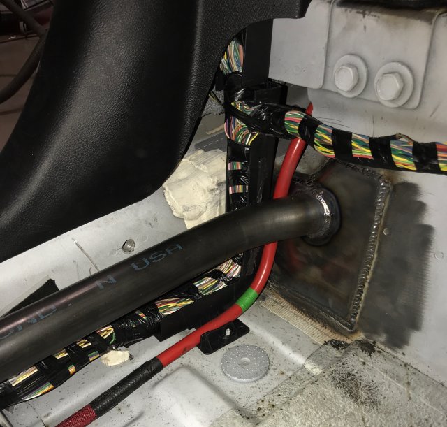

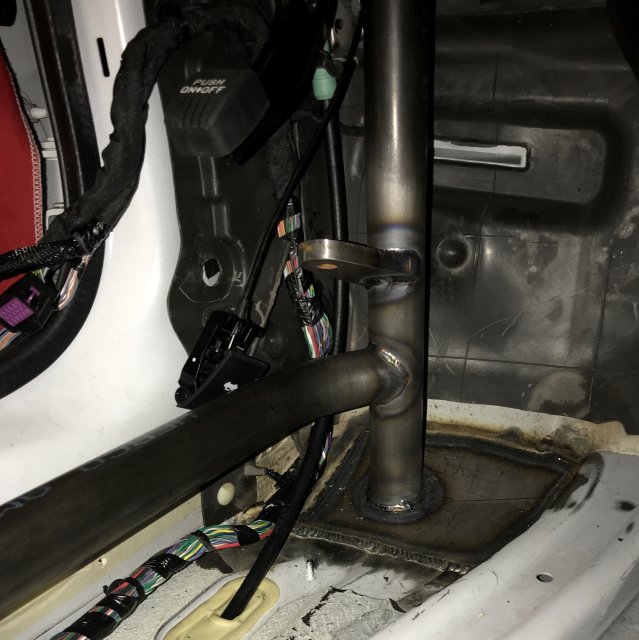

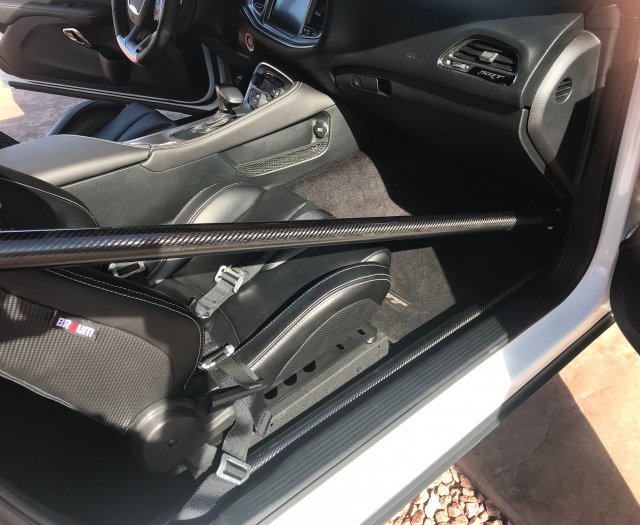

I know there’s a lot of confusion. Here’s what the NHRA tech enforcers like to see when it comes to a “cage”. DF797271-77AE-4092-8F9C-24CA4B5D930F.jpeg 9AA84A67-45DC-41EA-98F2-88EA98548916.jpeg 4148A696-445D-4004-945F-263AE79820BB.jpeg F94ED470-31FB-418B-BF26-7ACDDF6FAD79.jpeg 2A19EE8B-43B5-4255-AEC7-04162BF3C75F.jpeg 95B3DA61-D108-4E3F-853E-2FA2C68A742B.jpeg

I know there’s a lot of confusion. Here’s what the NHRA tech enforcers like to see when it comes to a “cage”. View attachment 13260 View attachment 13261 View attachment 13262 View attachment 13263 View attachment 13266 View attachment 13265
Thank you Marc! that is exactly what I needed to see. Thus, need a full cage.
I have reached out to my mechanic and let's see if he can build or get someone to build an over the dash cage for the Charger.
Do not want to destroy the dash, if we can avoid it. The end game is to revert this car back to stock, trade in for the "next project". Because selling a race car is a smaller market, if that makes sense.

I understand exactly. When I went to the shop to check on having this done I was very concerned about all the potential issues with removing the dash. Will it go back in place without damage? Will it rattle or vibrate? What about all those electrical connections? I asked them about “maybe” doing the in front of the dash approach. No offense to those that have that. His quote.. not mine! He looked at me and said.... “we don’t do half ass stuff like that”. 😂. They removed and replaced the whole interior of the car (including the dash and everything in there) like it was nothing. You can not tell it was ever done. The damage you’re talking about is confined to the narrow strips of plastic that have the speaker vents in them. They are separate from dash and can simply be replaced with new ones if wanted later. These guys didn’t even need to remove the speakers. They are still in there and working. 92C1019A-0C14-4AF8-8B2C-11EA6C39B4B9.jpeg

The design of the cage is important because it can actually contribute to the performance of the car on the track. When it comes to race cars... most of us understand that a stiff chassis is a important factor to have a suspension that works well. Track car or drag car.... it’s important that the chassis isn’t flexing. The stiffer the better. When we designed the cage in my car, it was important for me to tie it into the actual frame of the car. Some cages are attached to the floor pan with the rear down bars sitting on top of the wheel wells. There is no way that is as strong or as rigid as a cage that is connected to the frame. I placed the main hoop and it’s inward bracing on the cross member that the front edge of the rear seat rests on. This is a main structural piece of the chassis. A couple benefits of doing this is that the main hoop is short, allowing it to be moved around and even down to the floorduring the build to allow the overhead bar attachment and welding to take place. It allowed the welds to go all around the tubes on top. The NHRA actually allows the tubing in some places to not be welded all the way around where I’d can’t be reached. In that case, additional braces have to be placed. When my cage was being inspected the guy was running his finger around on top because I didn’t have any additional bracing. He commented that I was welded 360 degrees on top and asked how the hell that was done. I showed him that it was because of the placement of the main hoop being up high, allowing it to be lowered during the build to get that welding completed. It also allowed the head liner to stay in place as well as the front windshield during the build. Many of the cages you’ll see with these require removing the windshield to do that welding. Another thing I did was to install a sill bar. If you know what a subframe connector is.... that’s what this does. It ties it all together down low. All this isn’t necessary to just be allowed to go under 10 seconds, but my intent was to go a lot faster than that so the extra effort was made. Here’s a picture of the sill bar setup I’m talking about..... 4F36FD0C-B7FF-4BB3-941D-9980AA6FA838.jpeg 07664FCC-5EC5-4351-AF5E-9786AB6E1AEA.jpeg 1360C8DC-8EB0-45F2-AC6A-D17E3F9A6B31.jpeg DD5FC336-3A58-494D-9B07-5AE764DC6B6A.jpeg
