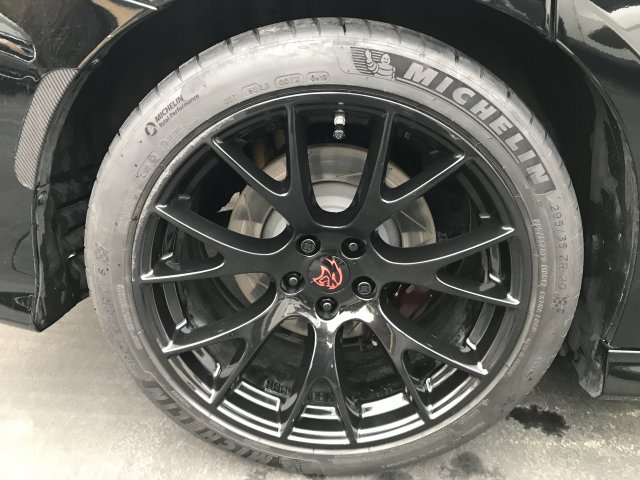

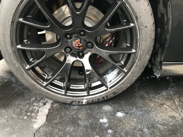

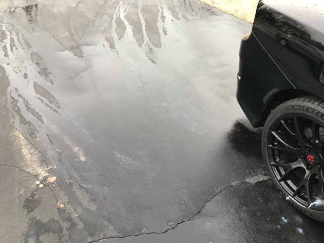

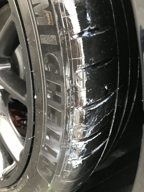

8ADB051F-7731-42B6-A852-753B3DB84285.jpeg FCBB92A3-BDBC-4F9B-AEE8-E919D49F9CD7.jpeg 3D0B2F05-4757-42F1-BB36-57EDD7037041.jpeg This was after I threw 3 buckets of warm water on it.. compressor failed and blew milky water all over my wheel and tire! Was scary! Lucky the residual goop was easy to whipe off! After 20 minutes of cleaning everything.. just wanted to top off the tires and this happened! Was wild be careful guys.. literally a quarter gallon of milky goop was shooting everywhere as soon as I pulled the line off the tire.

This was from the factory compressor in your trunk! I spoke to srt tech and he said sometimes the lines can freeze and this can happen! Be careful don’t let it be you too! Wasn’t very fun. But all is good now. 856C5589-533A-4634-B156-E91589AA6478.jpeg

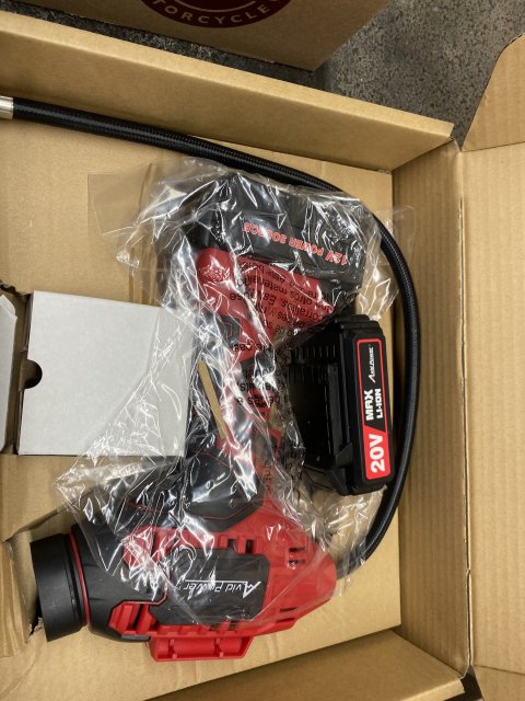

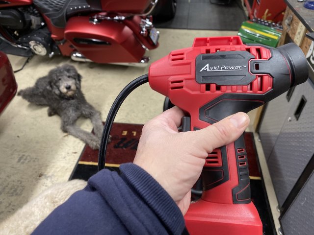

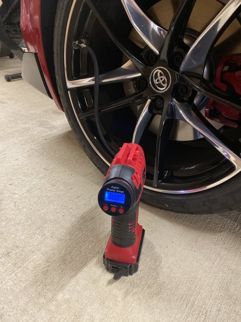

Save your aggravation and get one of these they really do work.

Just only ever use that thing in a true, last-ditch, emergency.... Arguably, that's really why it's there. It would just be nice if they made the thing more obvious...
