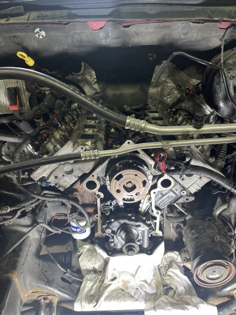

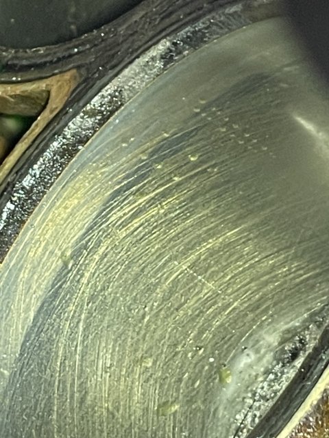

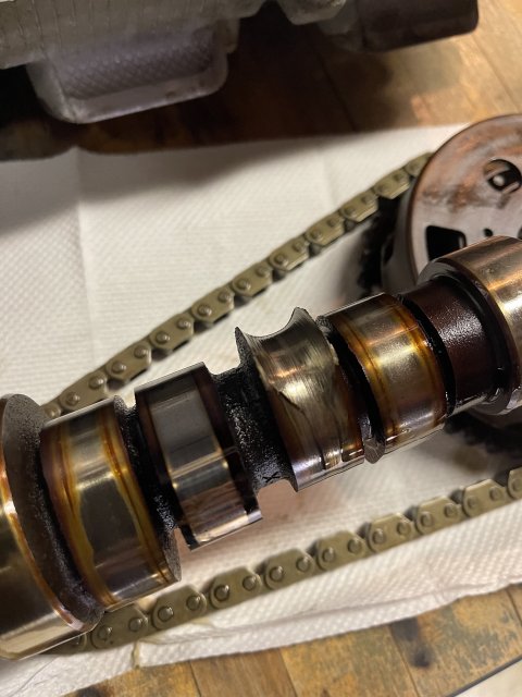

Well it’s not a Hellcat but I figured out what was wrong with my Ram IMG_3797.jpeg
Still has factory cross hatching at 189,750 miles

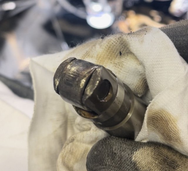

Change the cam and do some upgrades they said, it will be fun they said…nope! Not fun in this heat! 71140761911__A0139DA7-0223-4970-A2B0-20F2BB7E77ED.jpeg

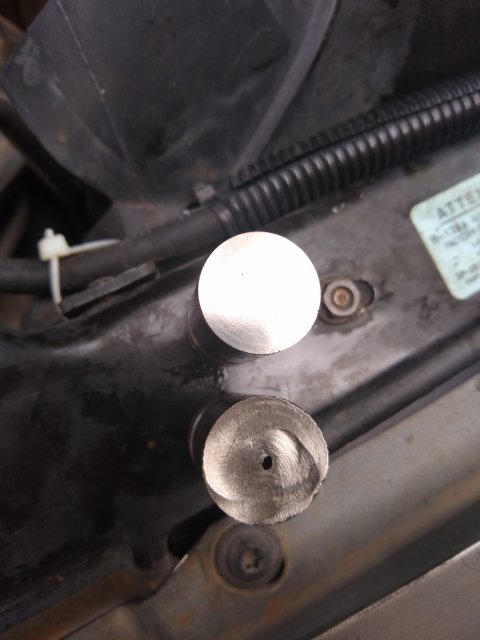

I feel your pain! 2 summers ago I had a lifter go bad in my Jeep. It was anything but fun to tear it down in 100+ weather. IMG_20210606_174923622.jpg

Now that's some scoring....

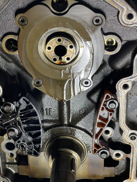

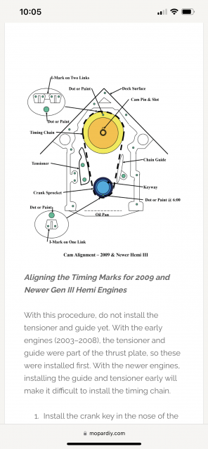

Well I’ve hit a conundrum!?
Cam might be bad🤣🥴 but this is the position when I pull the timing gears off and as you can see the crank position match’s but the pin location on the cam is 180degs out from what every thing I’ve looked at says!! Is it possible that the chain kept skipping teeth until it was that far out? By the time I got it in to work on it it had NO power! Couldn’t even get out if it’s own way! IMG_3807.jpeg IMG_3804.jpeg IMG_3808.png

Might as well add some power, since you're in that deep. Had a lifter go bad, in my 6.1. Ended up with a Spartan cam, new valve springs, oil pump, timing set, motor mounts, a tune... yeah... all kinds of fun.

For what its.worth i had an old expedition that had a chain slip like that (but not to that degree). For the life of me could not figure out how it did it. Seemed properly tensioned and tight. Happened on the highway under moderately heavy load if i remember correctly, sudden drop in power, increase in racket.

Which cam lobe was it? Was it one of the back 2?

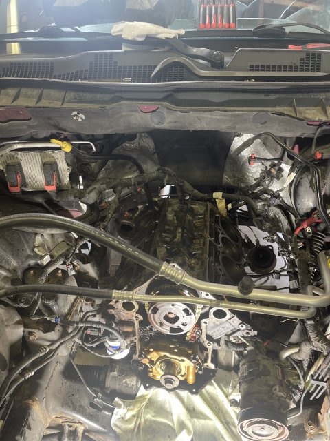

Starting yo look like an engine again! New cam in, new lifters in, new oil pump, new timing set, mds delete done, VVT lock out complete. Installed heads with headers on (stage 8 fasteners) and spark plugs in😎 I’m lazy like that!

Same thing happened on my 79 Camaro 350. The head of metallurgy where I worked at the time came from GM and said it was a very common problem. When they heat treat the cams, they hang them from the flange in front and dip them in the quenching tanks. Sometimes (more often then than now) they fail to clean the sludge out of the bottom of the tanks so the back end of the camshaft is immersed in the sludge in the bottom of the tank which doesn’t give the same cooling and proper surface hardness.
Sucks, but you may be another victim of cost cutting or poor/lazy maintenance.
