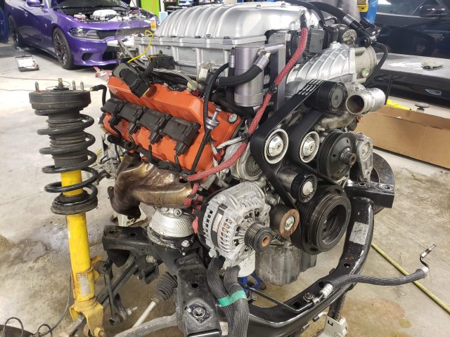

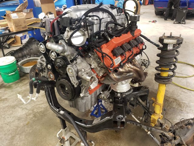

Luckily it's January here in Chicago and not "good" weather. I decided to "tinker" with the car in the off-season, which exposed this problem sooner than later. Shortblock arrives in 2 weeks, and then it will be buttoned back up and finished. I'll provide more details when it is completed. 1623102E-66BA-4C2D-84AC-51F90A9E196E.jpeg 3F12F697-9080-4ABD-AC31-6FE14AB4E044.jpeg

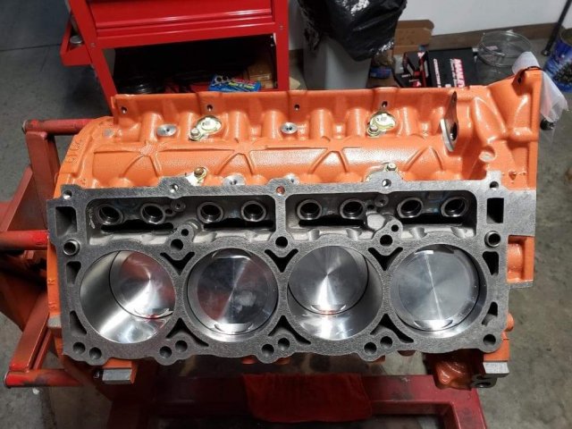

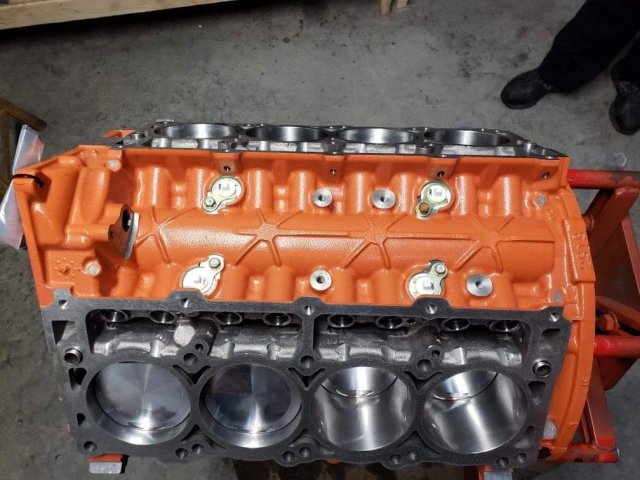

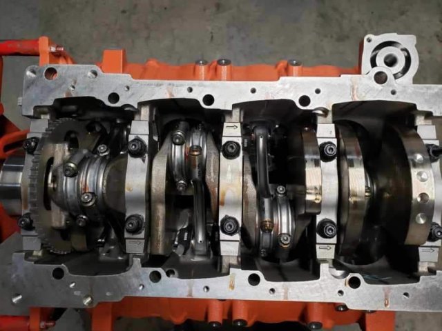

Motor is done. Hope it ships tomorrow.
23BD499F-C5FB-4970-85D0-10E025EAD27E.jpeg C66A636C-C75E-492A-9250-9DE0DB860738.jpeg BF71BB6E-8CEC-4785-837F-32D838A17A08.jpeg

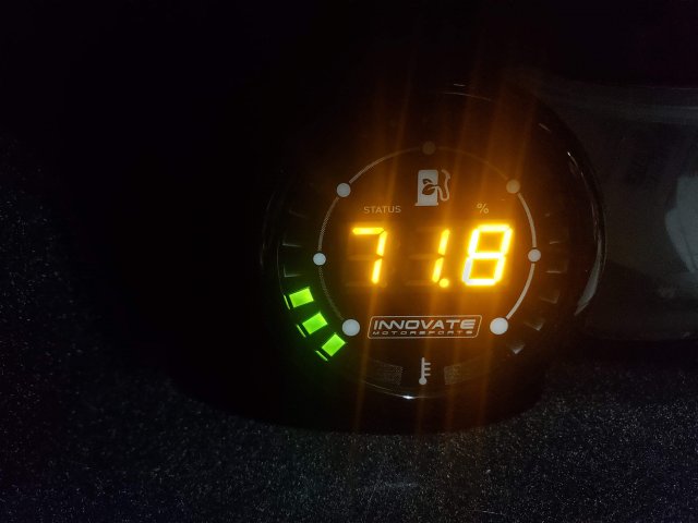

I was full time since 9,000 miles. This tune will allow me to run one tune for everything, just can't go WOT on the 93 due to the small pulley.
It is similar to curt's flex stuff, but this one picks up the fuel changes quicker. I'll provide feedback on that when I do some testing as well.
