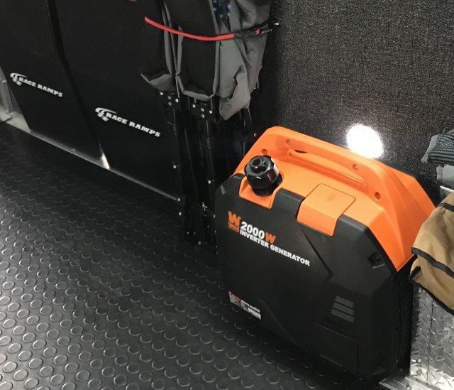

Charger for the track runs off of?
3,278
10,399
11,710
19,829
Interesting

I'm waiting to see if the battery can be charged sufficiently between runs with that charger.
