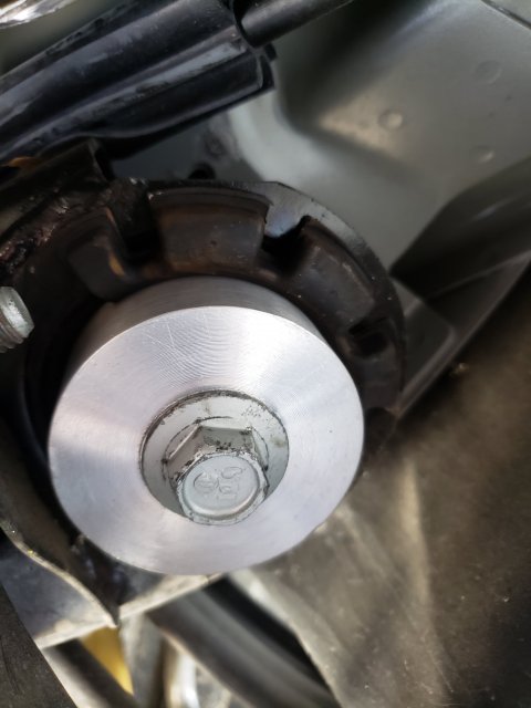

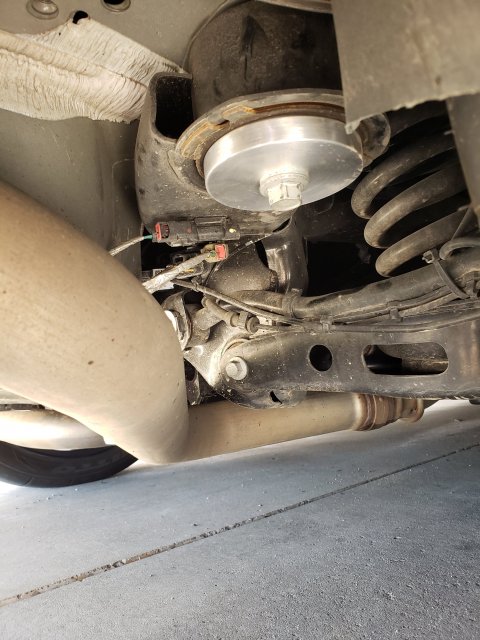

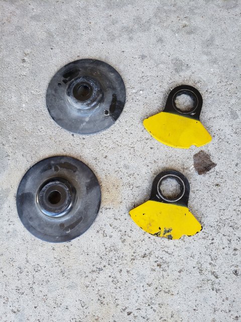

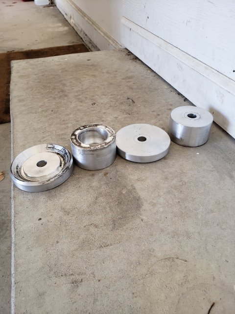

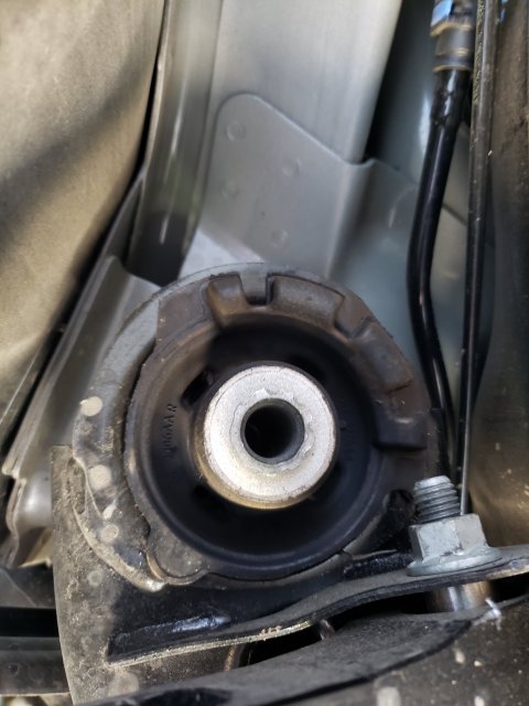

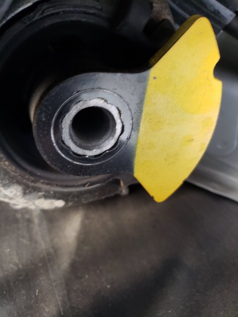

I did the install today. Took less then an hour. and I did one at a time. The rears you just take the bolt out, the black cap comes off and you put the piece in. The fronts you need to take the plastic cover off that run towards the front of the car under the gas tank. There is one on each side. For the front I loosen the bolt but left it on. There is a metal yellow tab you need to remove. Use a breaker bar and you can pry it off, you don't need to drill the side to get it off. The front just pushes on. I torqued the bolts to 126 ft lbs. They sure didn't feel like they were on that tight when taking them off

When I installed the lockouts I did the right rear 1st and was surprised how far the cradle dropped just removing one bolt. Now they are all in I'm going to take that bolt out again and see if there is a big change
There is a video on youtube changing the arms to AADs and he took both bolts off of 1 side, didn't touch the other, and was able to get the arms off so there must be a lot of play in the bushings

Prying the front tab off you really see the movement in the front. The lockout fills the empty space up so it cant move

So looks like this design has the metal bushing sit down in the aluminum cup, and sandwiches the rubber against the sub frame. Any thoughts on that causing the rubber to fatigue or tear?
Also, what is that yellow tab for that gets removed?

The pieces are aluminum. I would thik there would be less fatigue being the rubber is moving less
Darrel said the tabs were for alignment of the direction of the bushing when installing them from the factory or something like that.
BMR has you drill into them to remove them but they do pry off

Yep they are. I believe Darrels were made before them. The bmrs have the ring on the bottom of the front so you have to cut off the excess rubber so it fits flat. I don't see the upper piece being hard to install being the cradle drops by just taking one bolt out. I don't know how much more the upper ring will help
The bmrs also have metal to metal contact where Darrels are only touching the rubber
Based on what I saw I have no idea why you need to take all this stuff off and lower the cradle 6" per bmrs instructions. The tabs pry off without drilling
