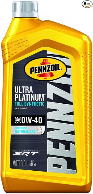

You should have never taken it out of there. 100% the wrong oil. Take it back. It is supposed to be 0W40 Pennzoil Ultra synthetic and will only be in 1 quart bottles. There is no substitute for it by the dealer. No question. Make sure they put an SRT oil filter on it. Tell them you want to watch the tech do it so you can look under the car while it’s in the air. They are also supposed to drain the oil cooler behind the passenger side of the front bumper. They have to be careful removing the drain plug from the aluminum block on the bottom of the cooler because they can crack the joint or twist it right off if they simply put a tool on the plug and try to turn it.

If they put the MO-899 filter on it, that’s fine. Original equipment on Hellcats and Demon. I would drive it gently until you get the 0w-40 in there.

That is what I put in my Hellcat!
