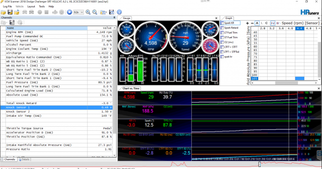

Are most desensitizing knock sensors on these cars? I see a fair amount of STKR on take off with a 2.85 and e85 using stock timing down low. Ramping it in up top I get no STKR. I feel I should be able to add 5 to 7 deg down low without getting any STKR.
I'm thinking I'm going desensitize a little to a little bit in the ranges I am seeing the KR.

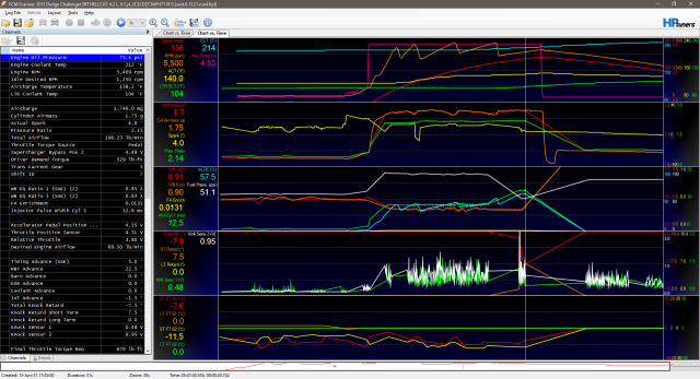

I'm not seeing anything that bad. Maybe what I am seeing isn't even bad enough for me to worry about.
4,253
10,584

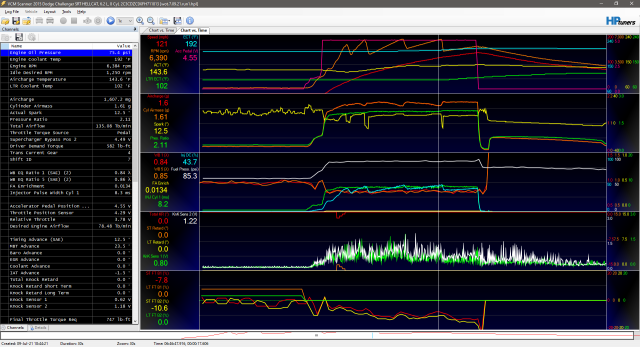

Hmm actually glad I just went back and looked at this. That log actually wasn't from a tune I touched at all and was from an e85 tune that I paid for that I reviewed. But looked at the fuel. It went a little lean for a quick second and when it richens back up it slowly goes back to no KR. STFT aren't bad there though which is odd.
Glad I made this thread to catch that. Still a good question to be asked about the sensors. I haven't been back to the track with the tune I've been working on. I have been updating injector data on the street. I'll have to head to the track and make a few runs and see if fuel stays where it is supposed to before I try anything else.

Also with the knock you saw on e85 were you getting smoke out of The exhaust at any point? Or did you have any other symptoms besides knock in the logs?
Also in this log it looks like knock sensor 2 is the one that spiked.
I’m not sure about other logs. But looking at a chart of placement it’d be my guess that would be the one that picked out the most blower noise.
But cylinder 7 is also on that side.
