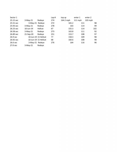

Okay, what did the numbers show?
Vast improvement on a 60-130 elapsed time up the straight. I was even able to post my 6.6 sec calculated time on the 60-130 thread for the first time, without being embarrassed. The Redeye is performing as expected!
An improvement of 5 mph on top speed from about a max 162 mph (707 HP Hellcat) to 167 mph (Redeye).
A solid consistent improvement on the sector time of the highest speed up the straight and including turn 1 & 2. Best sector times average a noticeable difference. The best sector time was more than one second better in the 25-26 second range than that absolute best "hero" time the 2015 set only one time, the best ten are shown below.
In the high speed turn sector to demonstrate the absolute stability perceived and to show real results, the Redeye has captured seven of ten top spots. This is the sector including turn 1, 2 and entering #3. Clearly the fastest sector on any road course in the USA because of the long radius turns and #1's bank. Notice the RE did do one hero lap last year (before controller), but the laps generally last week smoked it and the Hellcat! That '15 Hellcat was lowered. I can tell everyone, if your rear axles can support it, lowering the car most definitely gives an advantage. I just will not lower this unit because of the horrible problems experienced on my previous car up at BIR.
Sorry, a nice table was automatically formatted on a cut/paste in the "other" place. Since it would not do it here, I inserted a picture of the data as best I could.

It has, and compared to what we were doing 2-4 years ago, about three seconds are locked up, which is depressing. Let’s talk this week about a couple of things.

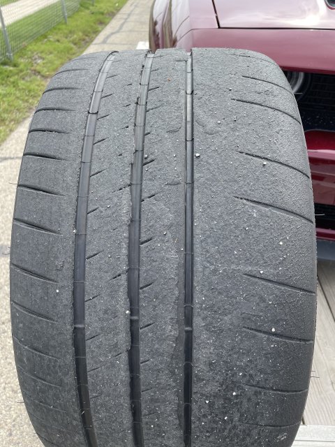

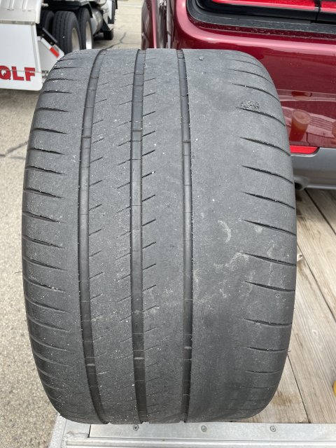

The bottom line is to do several things and I’ll share, IDK.
Get the AAD stuff.
Set the car as close to zero camber in the rear as possible. Set the toe just a hair toe-in. Flat is basically all square huh?
Tires love it! At least six or more days on these rears!!
6EB10398-694D-4C7F-A5A8-FDF57871C9C9.jpeg Set it and forget it, great for street and road course and probably works fine on the drag strip because the AAD parts hold the static settings so well under pressure. My street 345/30’s look the same for edge wear. None.
Front. If you change the setting from street to heavy camber negative you must also adjust toe. Jury out if it really matters to change the negative camber back for the street or not. Wrong toe settings wear tire edges not camber settings. Seems just fine to leave them at max negative camber (-2 degrees) and again just a hair (just a little hair maybe total 1/8” in 30” toe-in and confirm each side is balanced and pointing equal).
Front. A soft Cup 2 325/30 one day BIR one day RA. I am really happy!
That toe adjustment is very sensitive. I actually like the OEM front adjustment better than my rear tab set-up AAD uses. I am using 0.5mm tabs. I swear it could use smaller!!

@DGatzby , those tires look good.
