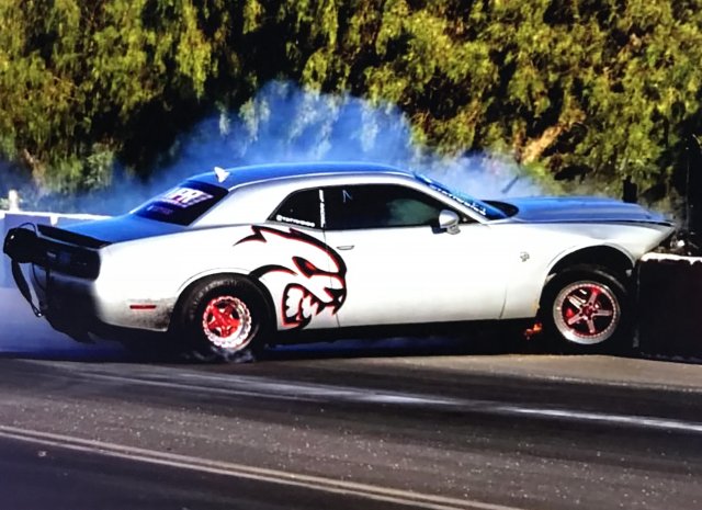

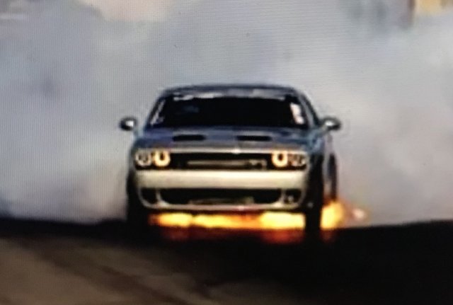

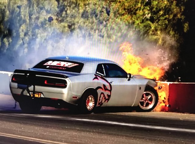

This happened yesterday on the Irwindale 1/8 mile in Calif. E886F300-17E0-47FC-A836-82AFDC5C1E97.jpeg 39E7D00F-E892-46E9-9D38-625C9AAE89B9.jpeg 05CCB681-E6DE-4BB0-8FFC-8F70902AA812.jpeg West Coast racer Tatiana Weiss had what appears to have been a engine failure in her “Growler” Hellcat. This is a built low 9 second (potential 8 second) car. She’s a experienced racer. Pictures pretty much tell the story. I’m pretty sure that she, like 99% of everybody else, was not running a ballistic engine diaper. This is why we should 😐.

Same one I have. I just recently shared the details of my new pneumatic chute launcher on the build forum here. I also did that on my Instagram page and Tatiana commented that she thought that was a good idea and said she had been thinking about the safety concerns of loosing control and the potential for the chute to possibly save the day. That was on Friday. This happened the following day. She has a chute, but obviously was not able to get it out in the time it took for her to hit the wall. The whole point of the diaper is to keep this from happening. I’ve seen the white cloud of death followed by a car careening off the wall so many times I’ve lost track.

Thanks for sharing always good to know that it's somebody made it out safe. Do you happen to know how badly the car was engulfed how many seconds it took to put out the fire?

It looked like the fire went out quickly and did not continue to burn. I’m not sure at this point exactly what happened, but the huge cloud of white smoke in the first picture indicates a blown motor. Damage looked to be confined to the front of the car so hopefully it will be reparable.

As long as the front frame rails were not bent it's repairable.
In that last pic I'm not so sure.
11,710
19,832
Photo number two, to me, looks like there is a huge amount of the drivers side front in/over that wall

Can’t say from the pics if it’s salvageable. After the wall, it spun onto the track without any additional contact, so the front end damage was it. The fire went out so that’s fortunate. She said that it lifted a cylinder head and then the engine blew. To me that means it breached the head gasket and hydro locked one or more cylinders. When that happens… it don’t matter what rods are in there. I know that she had a recently “built” motor with one of the new 3.0 Whipples. I don’t know whether the choice of internals included the necessary $2k head studs. That was a painfully expensive choice I had to make. I know it didn’t have the $300 diaper that would have kept her off the wall. I hope she gets back up and running with the necessary improvements.
