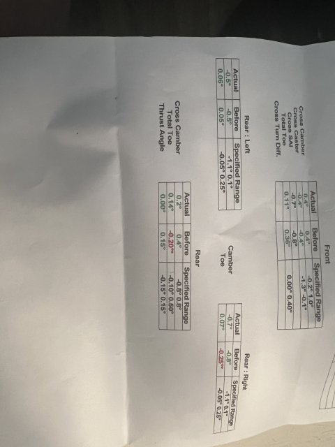

Anything in the prior alignment that would of made my car feel unstable at the big end?
Toe out on right side some on rear Take it you don't have adjustable rear arms being your camber is -.5 and -.7

To be honest I forgot. If I were to get aad parts which one part would I get. And what should I adjust the rear camber to?
The upper control arm kit to adjust it. Target would be 0 to +.3.

Makes sense as when the car squats if set positive the tires would go to zero camber and you would get a larger footprint for traction.

They come with +2 and +4 tabs. +2 suppose to be stock. Each tab moves it .24. So you we need +5 left +6 right or +4 and +5. You can buy tabs and split them up with 2 different ones
59,695
207,820
Tabs are sold in 8s. You could split it with +5 and +6. So if you bought the arms you would have 2-4-5-6 tabs. You could also split another with 3 and 7 with more options
My car had 5 and 7 in it but I now have Demon springs which lifted the rear and changed it. I had to change to 3 and 5 and I'm right about +.2 camber
https://aadperformance.com/products/adjustment-tabs

Thread Starter #14
My rear is higher. Not the demon springs. But the 1320 springs bought from Steve white a few years back.
Yep, that rear toe. Also he dialed in your front toe, it was too far out also. I’ll bet it feels better now.
8,577
52,752
Now be careful with camber adjustments. Your close now. But know that if you change camber the toe changes. The toe needs to be last set.
