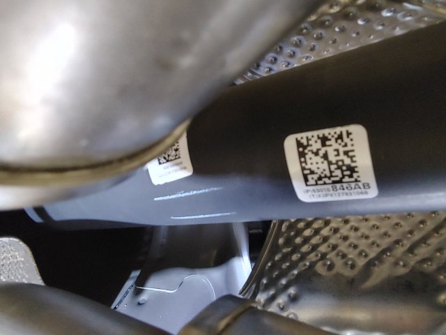

Confirmed today that driveshaft is indeed the same as Demon part number. 53010846AB.

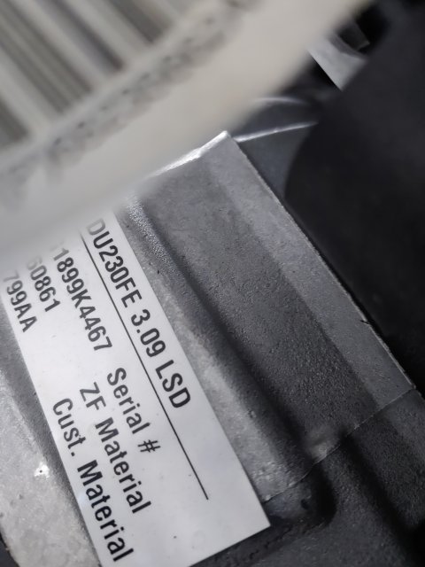

Got the Redeye home yesterday and put it on the lift. 0928190603_HDR.jpg 0928190610.jpg 3:09 gear option shows the 846 driveshaft and 799 AA gear that is the replacement for the 497 Demon axle
